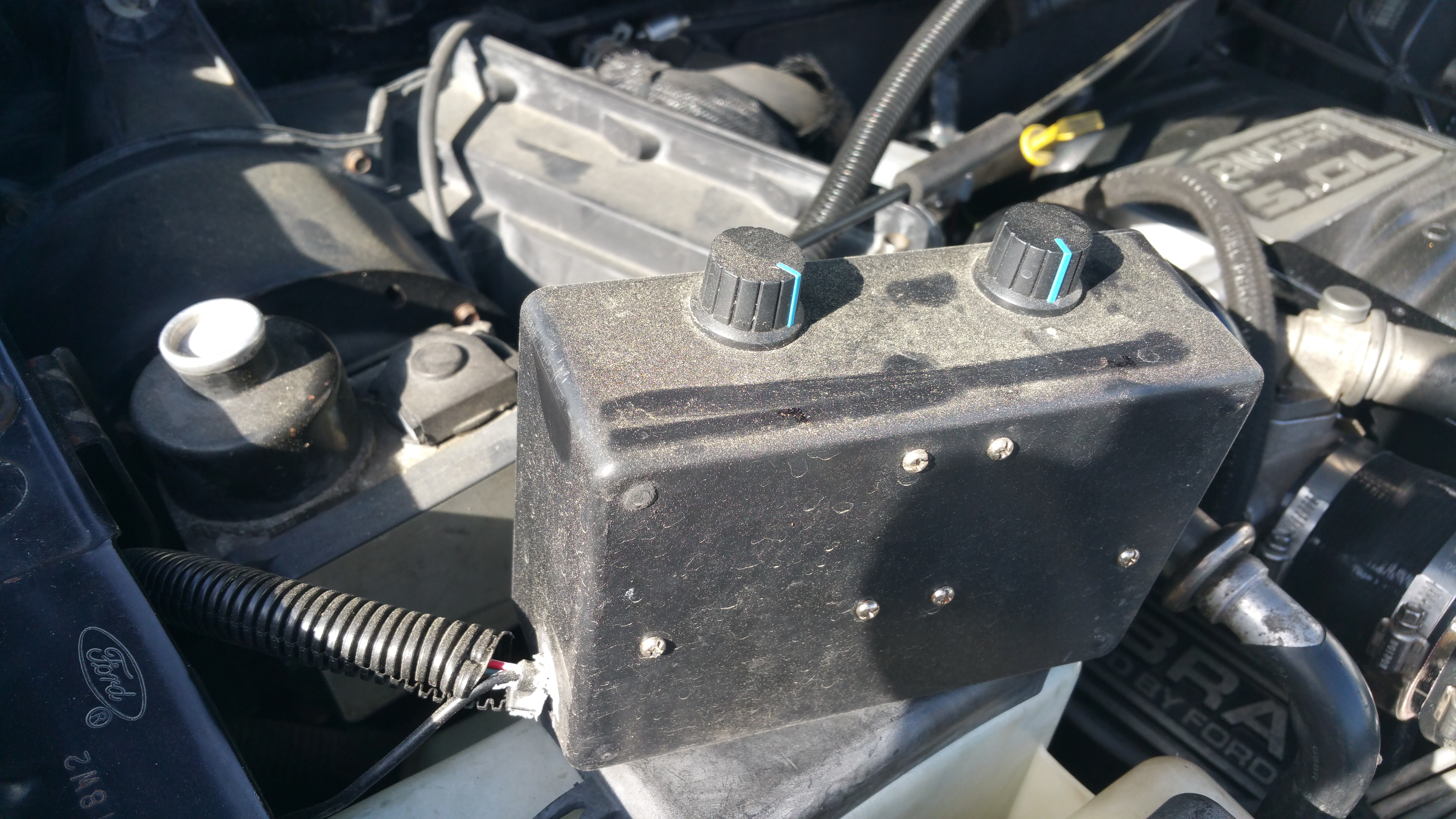

What are you using for a controller for the electric fan?

I'm using the OE pulse width mod relay box from the 2010+ Fusion. I built my own adjustable 2 speed controller that you can barely see behind the washer fluid container in the pic above. The pwm relay has a soft turn on (no big voltahe drop on start) and either 4 or 5 fan speeds to choose from.
I'm on my 4th revision of "my controller". I had to redo it a few times because it would time out on the high speed setting and run the truck hot w/ac on. Right now I'm waiting for some $5 digital pwm controllers from China to try and get it dialed in and able to adjust it from inside the truck. I've got it working good now with my "4th" setup but want some more adjustability.

Does that mean you are using the 2010 relay box and on top of that a pulsewidth modulator?
Or do you switch between the two of them.
Do you have a thread on that?
Reason I ask is that I have a Spal pulse width modulator on my supercharged 98 2 door that I really like but I know it wont last forever.
They were cursed with the circuit board trails burning up when too much current was flowing through them.
Anyway I would like to run electric fans on other vehicles but have not found a controller that I like.
There seems to be some other controllers that seem to be holding up but they don't look as water proof as the Spal unit I have.

Yes I use the factory relay box that is mounted to the fan and use my own box to control it instead of the pcm (Like the fusion). I am cheap and don't like the idea of using aftermarket parts that are expensive and don't last compared to OE stuff. I had a Volvo 2 speed relay setup before this one which was bullet proof.

That's cool stuff, thanks for posting those pictures.
Somewhere down the road I will look into electric fan controllers again and will keep these in mind.
