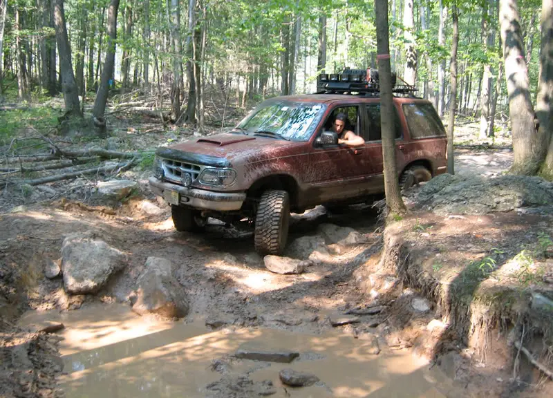

Yeah. For hunting a locker is a good idea , since hunting season usually means soft ground and possible snow. It'll make both wheels grab so you don't spin, get stuck and worse damage the trail or field. I'd stick with torsion twist on front to clear 31" tires, Monroe coilovers in rear for about 2" lift, and a rear lunchbox locker . You'll do good with that, it's what our Mounty is running now.
You can always go larger, but the above is doable for 1200 dollars including tires.

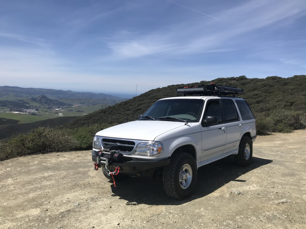

d4 which i believe is a 373 LS. cool! do you have sohc or ohv? i think 31s would work well for you crank the bars put shackles in the back or OME list springs like i did or both and then spend the saved money on a lunchbox locker ot good limited slip good tires... as for the rest.................... go to cabelas :) itll be gone soon enough
VIN decoder says SOHC
VIN Decoder shows SOHC but no gear ratio
ok thats fine since you have 373s if you look on the door sticker under axle thats on the bottom part of the sticker.
so sohc with a 373 ls. same here!!!!!!
loving the setup with the TT shackle & OME (only went OME since the original leaves were giving out), stock LS (need to upgrade clutches), 31s
id guesstimate in parts for my setup + the LS clutches you'd be in say...
TT- 0
shackle- 100
OMEs-500 (keep in mind the OME for some reason comes with no bushings?)
31s- 1200?? (depends)
alignment- 100
LS clutches- 200 i believe from ford racing (the carbon fiber ones) or for a lunchbox locker (which for hunting id go with is 500)
soooo about 2100 or 2400 id guess depending on if you go for a lunchbox locker or clutches.
id then spend the money saved (since this i think will get you through most hunting spots) on a winch bumper and winch, or some other sliders or other goodies.
