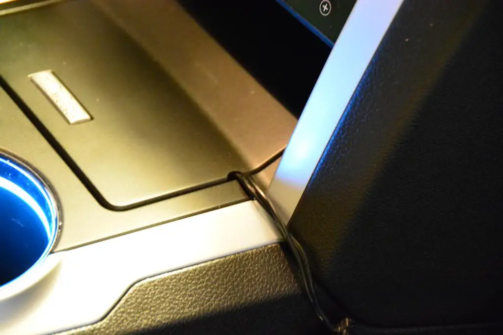

Sorry that's not my vehicle. I just posted the pic the original poster was trying to post.
Hey, THANK YOU "anonymous" for posting my photo, much appreciated!
BTW, I needed that "cut-out" for my radar detector cord that goes behind the glovebox and inside the right A-pillar, (didn't want to cut into any wiring or mess with the rearview mirror.)

Ok, finished up adding the media hub cable cut out in the center console last night. Turned out great!

No media hub cut-out? No problem. I made my own.
Take a fine rat tail round file and file the DOOR edge.
Make sure you mask off all the surrounding area so you don’t end up scratching or whacking anything. Take your time. File away until the cord has plenty of clearance and the door closes easily. My cut-out came out fine and smooth. Simple job. Looks “factory”. Problem solved. Total cost : $ 00.00 .
