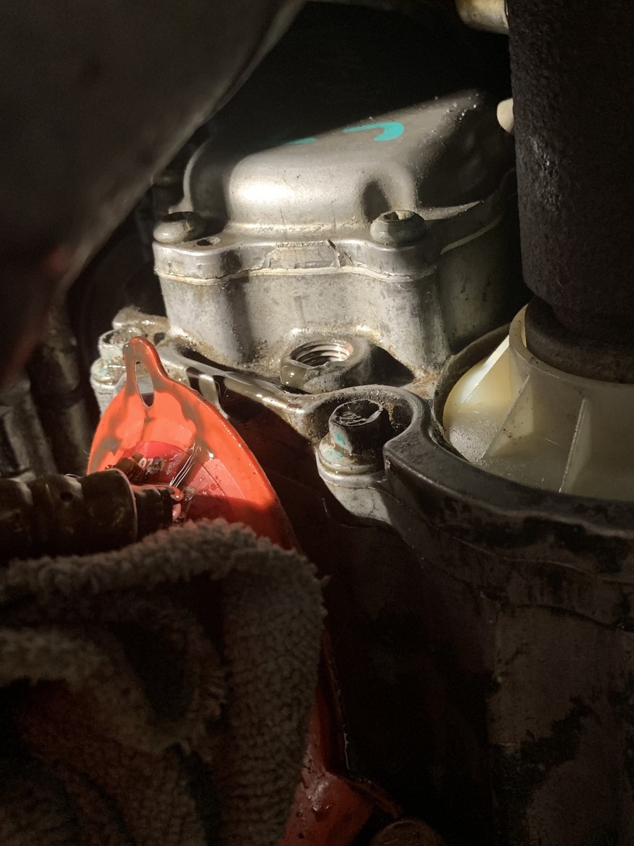

Decided I didn't have the patience to be careful with draining, so crammed a funnel under the drain plug and threw the pic oil drain pan under that with some rags to catch and random bits that ran away.

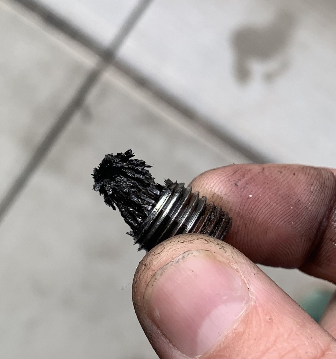

The furry drain plug!

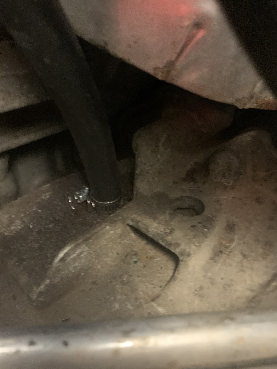

Managed to get the vent hose extended and add a clamp, there was nothing on the existing hose, and like @Rob_I I had no noticeable fluid around that, but the vent on the top of my hose had some very thick old oil on it.

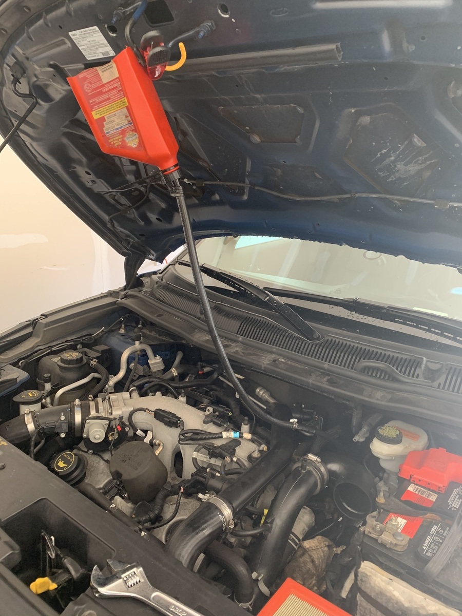

Homemade IV drip for the Amsoil, I thought maybe a more open container might help it drain faster than a sealed bag.

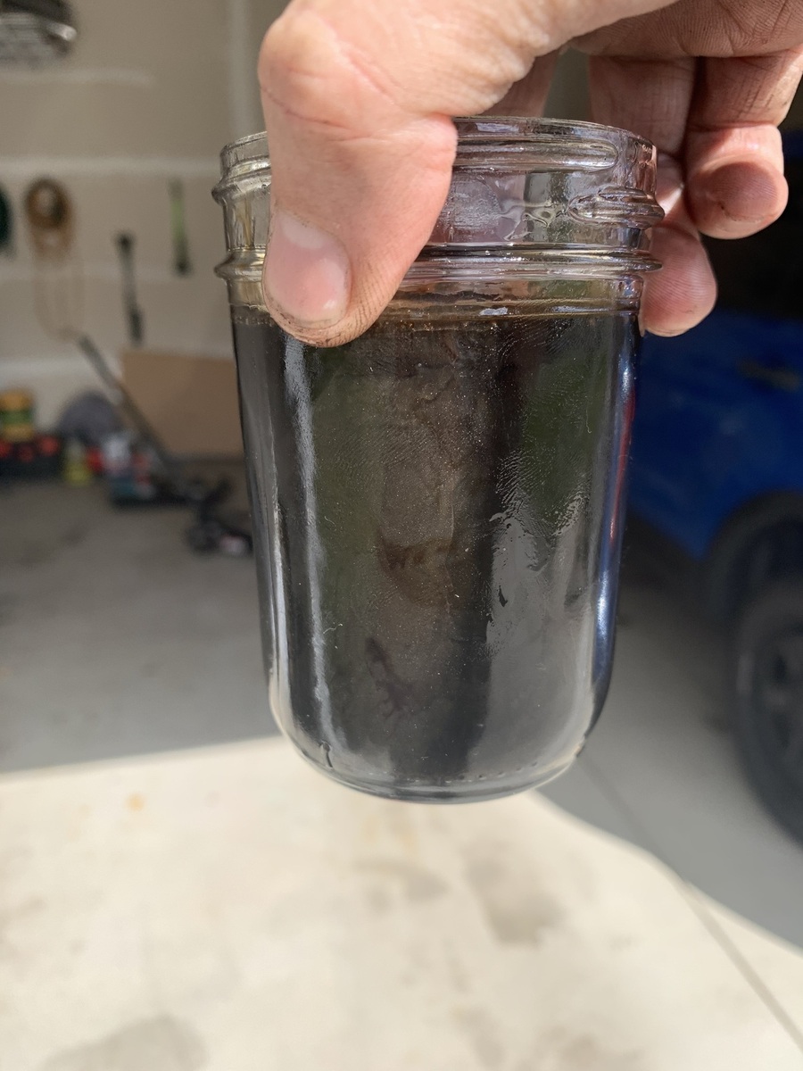

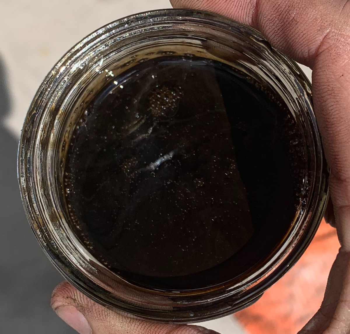

A little darker than the fresh stuff. And more sparkly.
