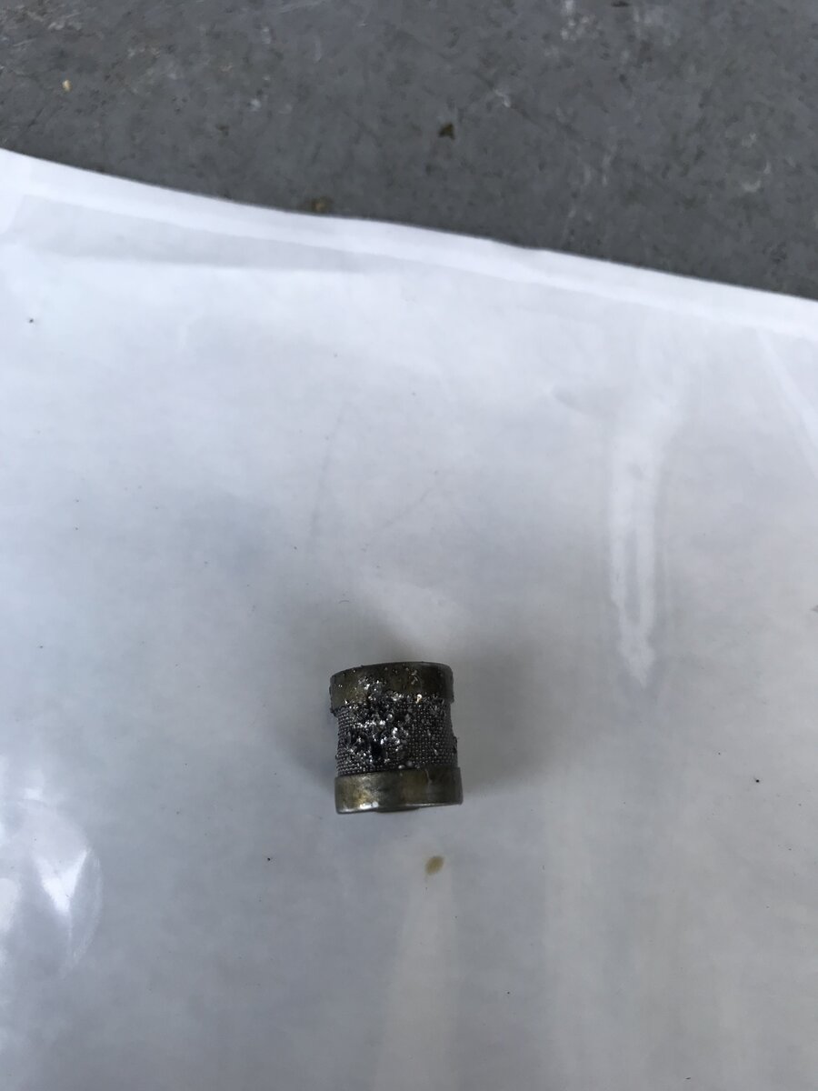

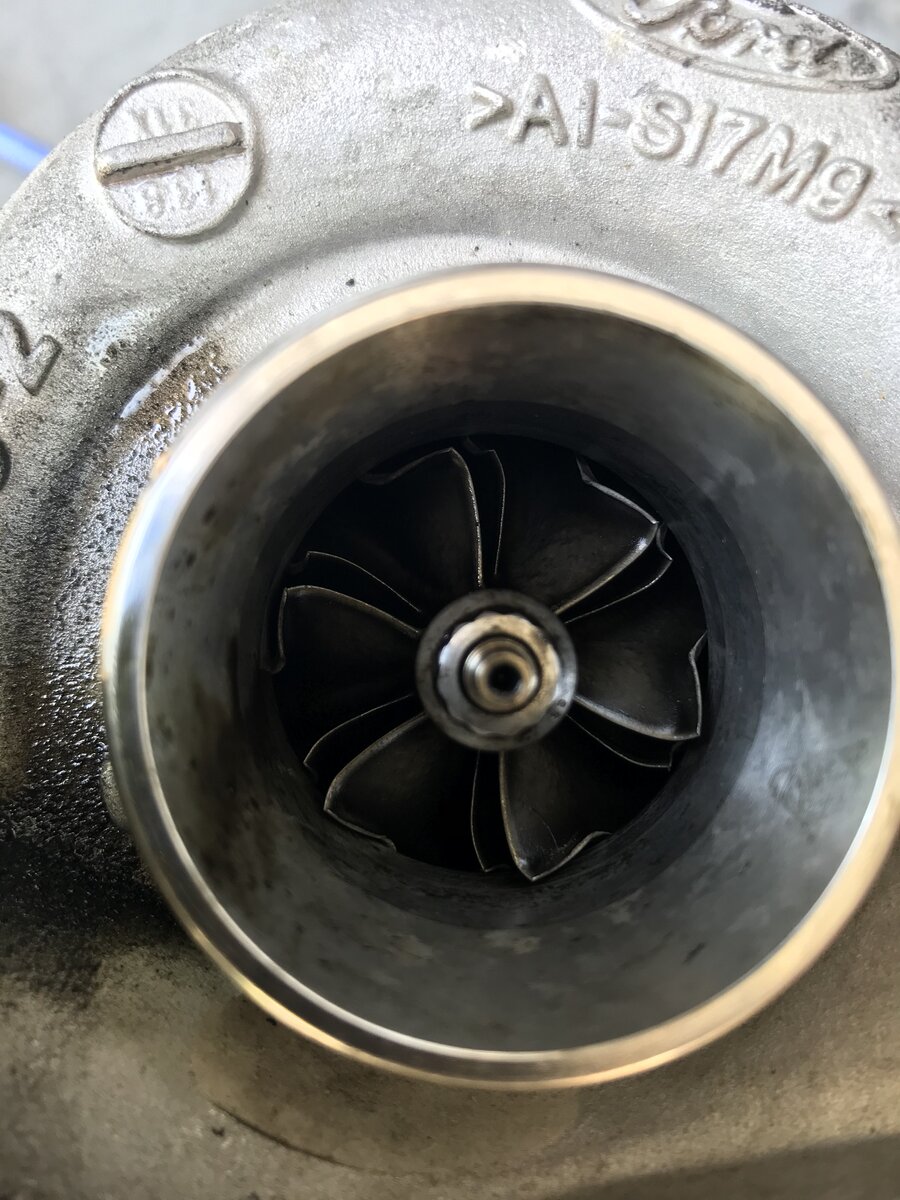

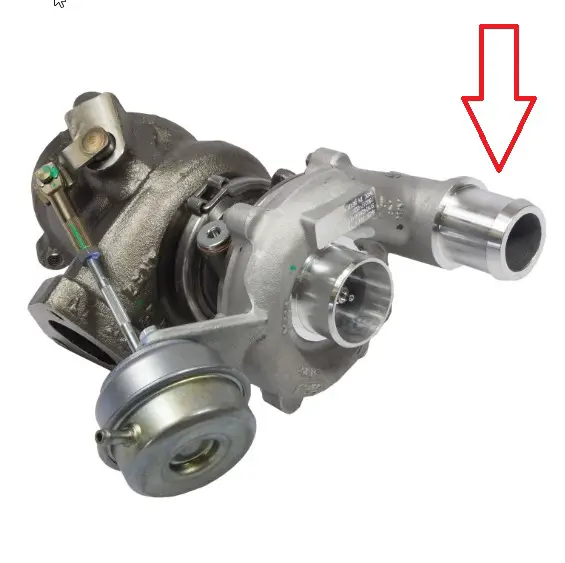

Was travelling on the interstate the other day when my 99k-mile Sport suddenly lost power and started making a loud noise under the hood when I'd accelerate. Managed to feather it back home, got in my shop and looked for any loose hoses. After 2 hours, couldn't find anything loose, so I fired it back up and it started smoking out of the left pipe. Verified oil and coolant level, both were fine. Then I investigated some more and decided to disconnect and pull off the easiest hose I could get to on the front turbo (see pic below). Well, oil started pouring out of this hose when I pulled it off the turbo housing. All these symptoms make me come to the conclusion that the front turbo has blown an oil seal and is leaking into both that hose and through the exhaust which is causing the smoking, and has also seized or is nearly there. Has anyone had a similar issue? I've got an appointment with the dealer next week and hoping that it won't be crazy expensive. I've already had the water pump replaced at a cost of $2100, along with new tires, front brakes/rotors, spark plugs, and three new coils.
