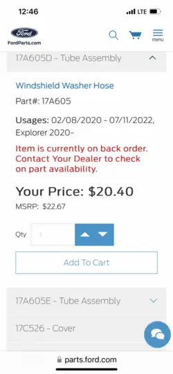

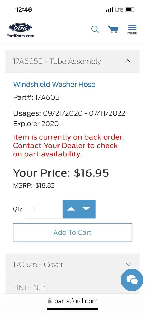

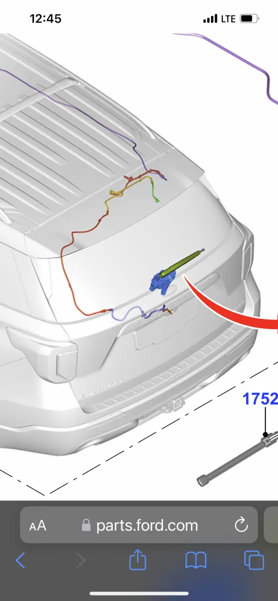

So my wife goes to wash the rear view camera and gets no juice. Rear window washer works. But nothing from the camera washer. So I make an appointment with the dealer where we ordered the vehicle. Upon inspection they find there is no hose present for the washer on the camera. Then nozzle is there. But no hose. According to the dealer our vin doesn’t show it having that. Funny because according to the order guide it’s standard on all explorers as part of the co pilot 360 technology. So now they are in discussions with ford about how to make it right and get the dealership paid for the fix. It’s really sad what ford has become. I’ve been a ford customer since 1995. For four generation since my great grandpa Immigrated from Germany we have been driving fords. Really disappointing.
