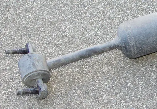

The front were a bit of a pain. On mine I had to hold the bottom with an 18mm wrench while I used a deep well on the top bolt. Only one bolt on the top on mine.
The only problem I had was getting them torqued to 35lbs. While putting them in the shock wanted to spin. On my new Monroe Sensatrac's there was nothing to hold onto to stop the spinning. I tried a pipe wrench on the first one but was tearing into the shock so I stopped. Then I put a little straight jaw pliers on the bottom and I think I got them to about 23 ft. lbs. Those little rubber pieces really compress down as you tighten the bolt.
The end on one of my shocks wasn't pressed in right and I had to return it for another new shock. Kind of irritating having to run back to the auto-parts a different autoparts store because the one I bought it at only stocked two which I bought that morning.
By the way you really have to take the front wheels off and put it up on jack stands to do the job. I'm happy to be done with it. I figure I'll check the bolt in a few weeks to see if it needs any tightening.
