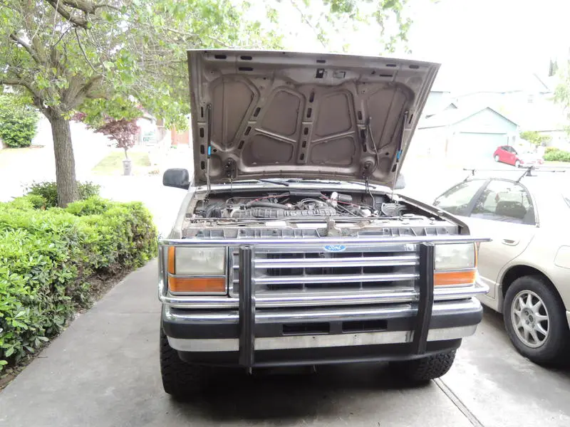

I got tired of that hood stand to I strutted my hood a year ago. I went down to Autozone found some struts that had a bracket built on one end and a bolt on the other. I don't know what there made for. I then used a piece of angle steel to mount off the fender. Works great when open the hood about 10" the struts push the hood up by themselfs.

There are a few here who have added struts to the hood of their first gen, so it obviously can be done....don't think anyone ever used the hinges from a second gen though...
