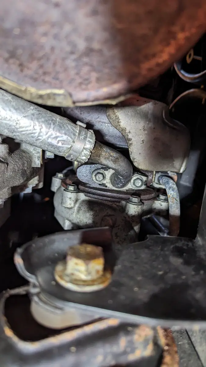

I noticed oil burning smell a few weeks ago, took my 2016 Explorer Sport to my mechanic for an oil change, He called me and stated there is oil leaking from the rear turbo. I just bought the car July 2020 with 72,000 miles on it. No warranty. :(
I disagree with Peter 100%. Any oil leak in an engine is a cause for concern and safety, as it can cause a fire. I have a 2017 Explorer Sport, with 51,000 miles on it! I have been having issues for about 9 months now. I keep getting engine misfire faults and emissions electrical concern faults, that are targeting both of my passenger side exhaust O2 sensors. I was told about an oil leak around my turbo back in December 2020 when I had been searching for a Ford dealer to do right by my concerns for loss of power, idling issues, poor fuel economy, etc. I was assured that the oil leak was around my turbo and not in it! However, I found the oil leaking from the passenger exhaust while the vehicle was running in Park and I was standing behind it, while it was raining. Low and behold oil can be seen on the pavement repelling the water on the ground. Hmm looks like oil is NOT only leaking around the rear turbo but is finding its way into the system, damaging O2 sensors, possibly damaging the cat and most likely the rear turbocharger! I have had mine in 3 different Ford dealers, one admitted there was an oil leak and "was looking into it" but they won't return my calls or voice messages (this is the dealer that found it first). Another told me it was so small and NORMAL! WRONG! No oil leak is normal! And the third just won't even look and wants me to replace O2 sensors. Why would I replace O2 sensors when the oil leak (that no one will fix) is what damaged them and will ruin new O2 sensors as well!? I need this escalated to a regional service manager! I have powertrain warranty until 60,000 miles or 5 years (2022). I purchased this explorer in July of 2020 and want to love it so bad, but am just getting my heart broken!
The OEM turbos are not durable... Especially as these vehicles age. Sounds like the internal bearing seal is gone and dumping oil into the exhaust. It is in fact ruining components as it leaks. I would stop the dealer chase and bring it to an independent Ford tech. If you have a warranty its pretty simple just ask for the manager and put the car on a lift. Have them remove the passenger catalytic converter and look inside the turbo. Im sure its caked in black oil.
I replaced the turbos on my explorer with aftermarket OEM from RockAuto and no more oil leaks ... And a helluva lot cheaper than a dealership.

2014 explorer sport that has the same issue. oil leaking from the oil supply line to the rear turbo. $1200 is what I was quoted to have it repaired due to having to drop the sub-frame to get to it.

Peter, Thanks for the response. I just found out about this turbo leaking this morning and haven't followed up with my mechanic anymore as he is doing the oil change and rear brakes today. He did state the turbo intercooler pipe was coming off and he was going to get that put back on, then look to see if the oil leak was external or internal so we could discuses options on how to proceed going forward. In the mean time I've been googling to see if this is a common issues and that's how I found this forum. I guess I'm looking for some clarification from anyone on here regarding the actual issue at hand. Does the turbo it self need to be replaced or is the oil leaking from a line, bad O ring or something? Just trying to get in idea of what I'm dealing with along with wanting to let my mechanic know what I've found. What is the typical life expectancy for the water pump on these? I was aware of the hood bubbling prior to buying, I have a body shop friend that used to complain about the issue a few years ago. My car spent most of its life in TX and has only been in WI for just less than 2 years. I do have 1 small bubble currently. Thanks for the help -Tom
Tom, I have a leaking rear turbo....what did you end up doing? mine is leaking externally and on the intake side as it is pushing oil toward the intake and leaking on top of the front valve cover. thanks in advance
