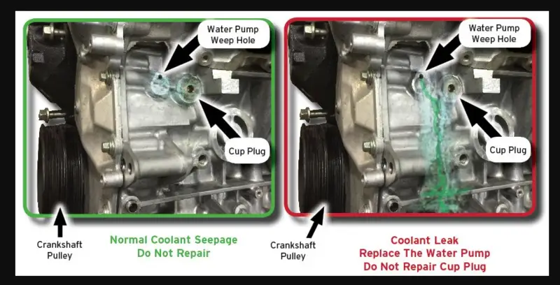

Thanks for the tips and pics! Can you try to point out the weephole? I know its behind the alternator and I can see where everything is wet, I'm just looking to see where the hole is and where it would start.
I never removed alternator, so I never actually observed the weep hole in action. That said, look at the attached pics for the passage direction.
I believe RobinsonAuto Ford Edge 3.5L videos showed the weep hole or maybe its my imagination.
Either way, if you look at the pictures I posted before and you have coolant in the same area, you got a leaking water pump.
Found this picture, not sure if it will help you much, but it shows location of the weep hole.
Thanks for that! I'm going to take a look when I get home.
worked on 2016 EcoTech 3.5L turbo explorer, same engine design. I was under the car and could just barely made out the weep hole behind the alternator. The picture I posted is a very good reference.

I have a 2016 Explorer Limited (70k miles). We have been getting a coolant leak out the HP6 plug that Ford designates it as. After further research on Ford.Parts.com it states in the description that " Leaking From This Plug Is An Indication Of A Water Pump Seal Failure". So that got me down this road. Looks like this turned into a much bigger job than just replacing what we thought was a worn plug. So when you stated "weep hole" I am assuming you are talking about the plug on the front of the engine block? It is right behind the alternator?
Hi Justin. Did you look at post #29 above? If it is leaking there, (weep hole) it may not be a good thing to keep driving the Explorer. Have you checked the oil dipstick for possible contamination? Your coolant level? Water pump failure leads to dead engine
Peter
Peter
I did look at the image and it is not just general minimal leaking. It definitely is the sign of water pump seal failure. It is not gushing out, just a slow constant drip when under pressure. I will drain the oil and replace once I get the new pump in. I will have to reread some of the posts to get a better game plan. Thanks
