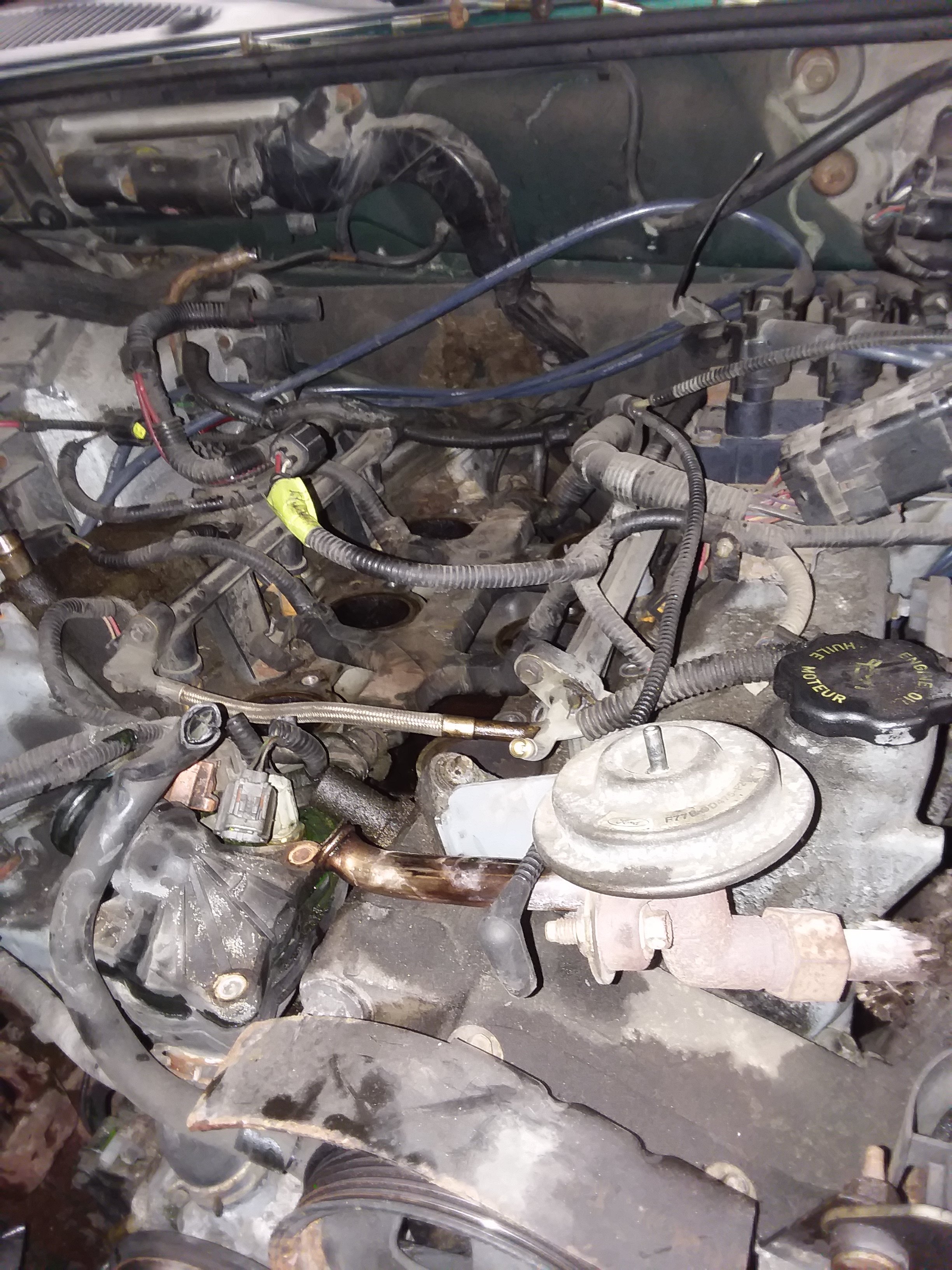

Im about ready to pull the motor out ive been going kinda easy because my buddy has a 4.0 with over 320,000 miles on it so im just trying not to destroy everything and give him some spare parts. Its a shame this engine is not that old and its a reman. Just a botched job so im going to give him the heads if he wants them. Heres some pictures im getting close to the fun part wgich is putting the 302 in...

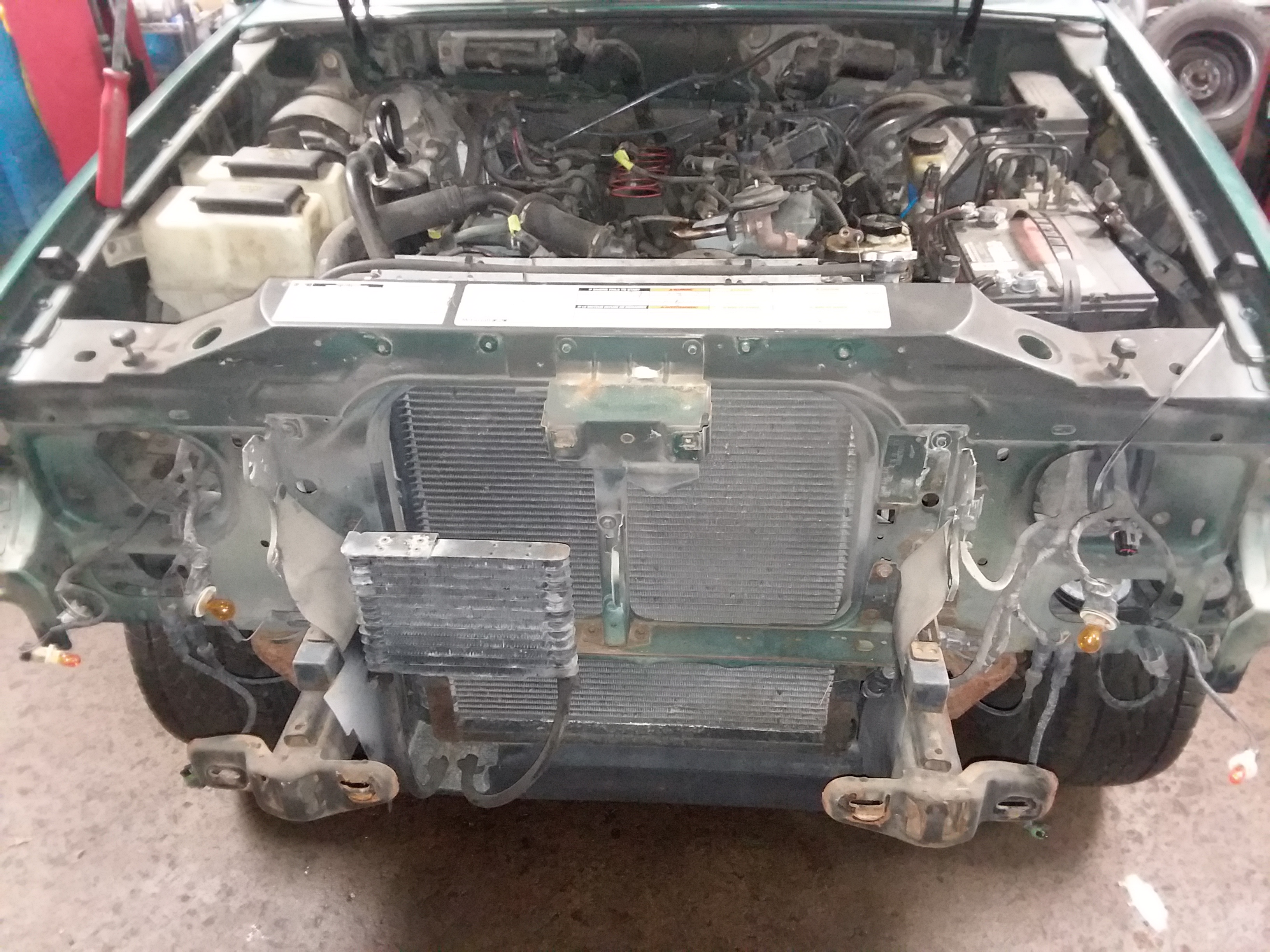

pulled the front end off for more room
radiator is pretty clean inside so im going to give her a good cleaning and re-use

FYI, save your AC condenser and its special bracket holding it to the support at the bottom. Those work much better than the 302 condenser, which has to attach to the V8 radiator. I've not done it myself yet, just know Tim and others have. Everyone hates the V8 condenser mounting, so the V6 version is a welcome improvement.

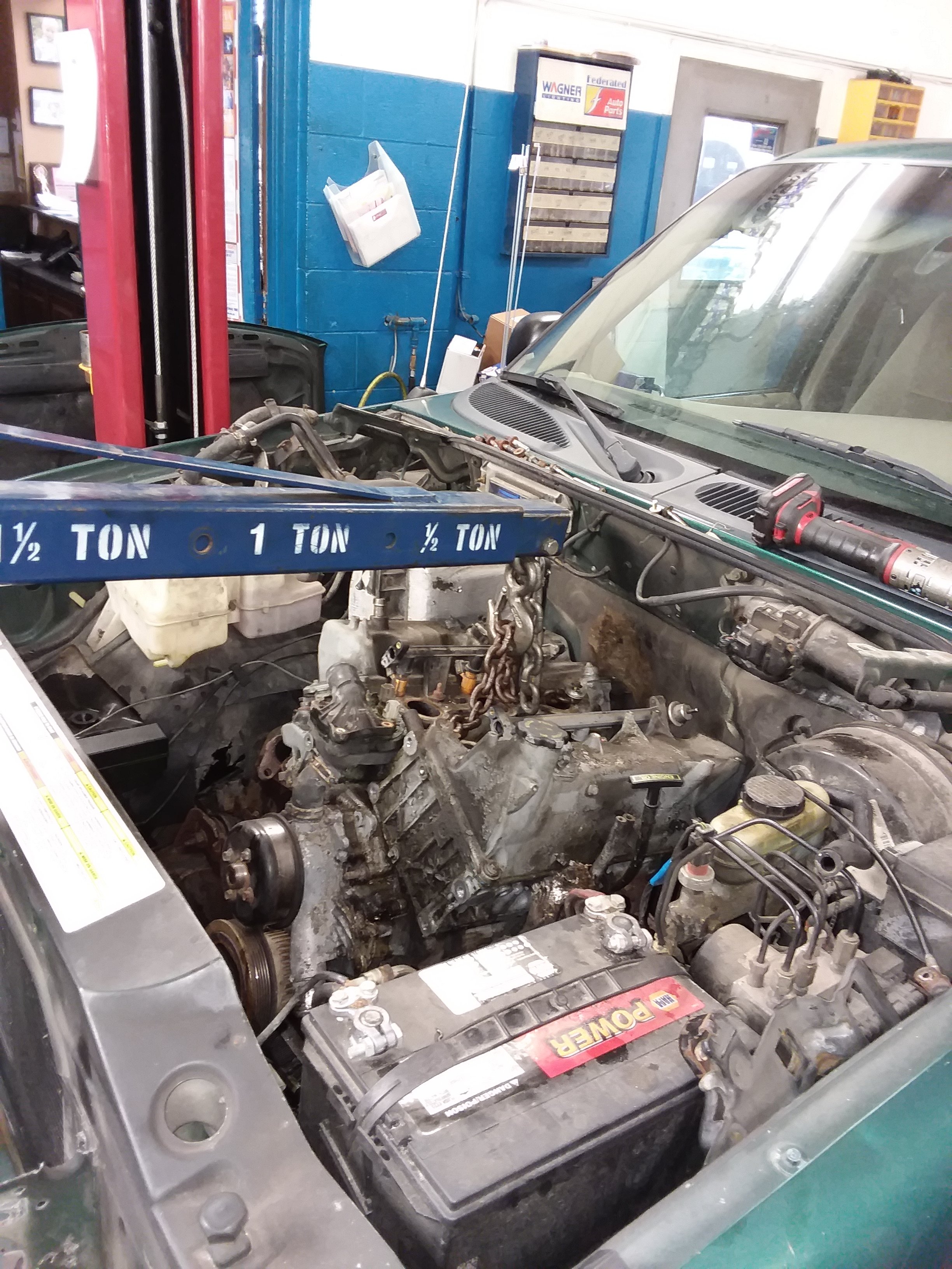

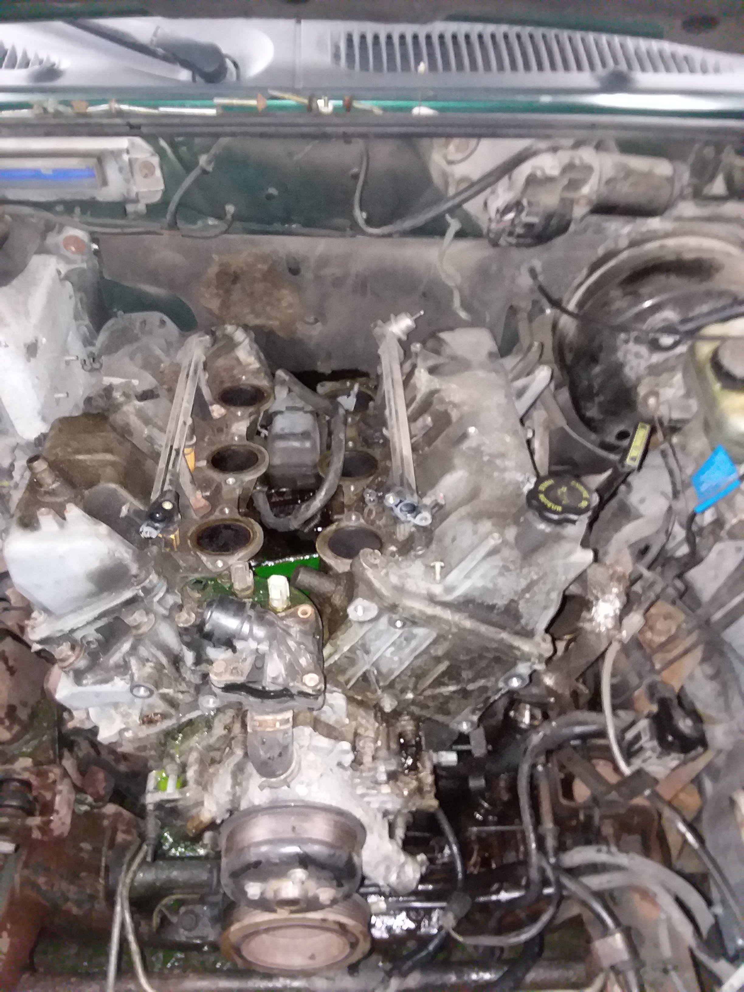

Well i couldnt get to where i wanted to be i lost the motor mount brackets and my lady wanted me to go out for my bday i did make it pretty far. Ill start again at 4am heres some photos

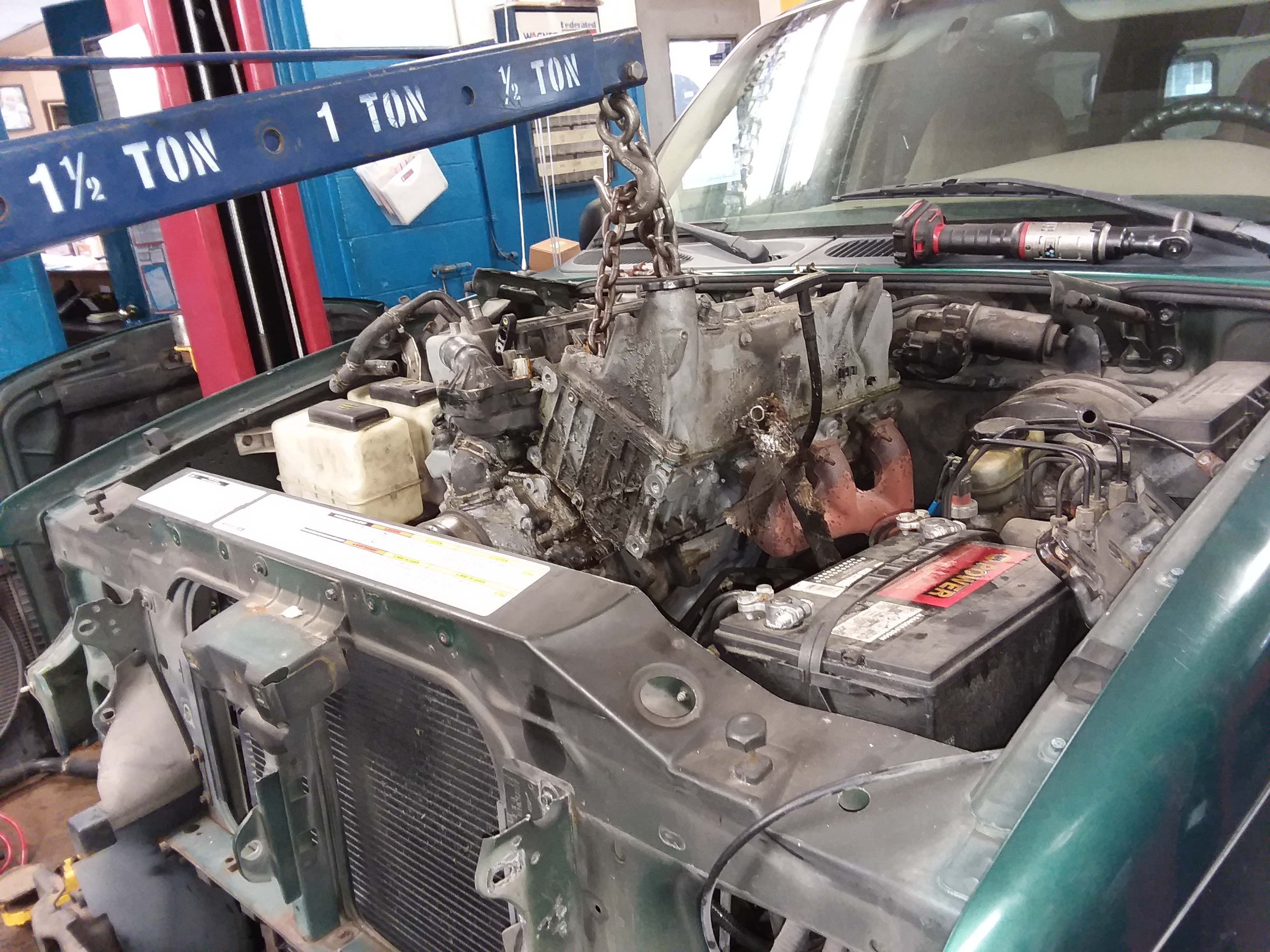

got her unbolted and ready to pull
almost got her out forgot to unplug the oil level sensor
