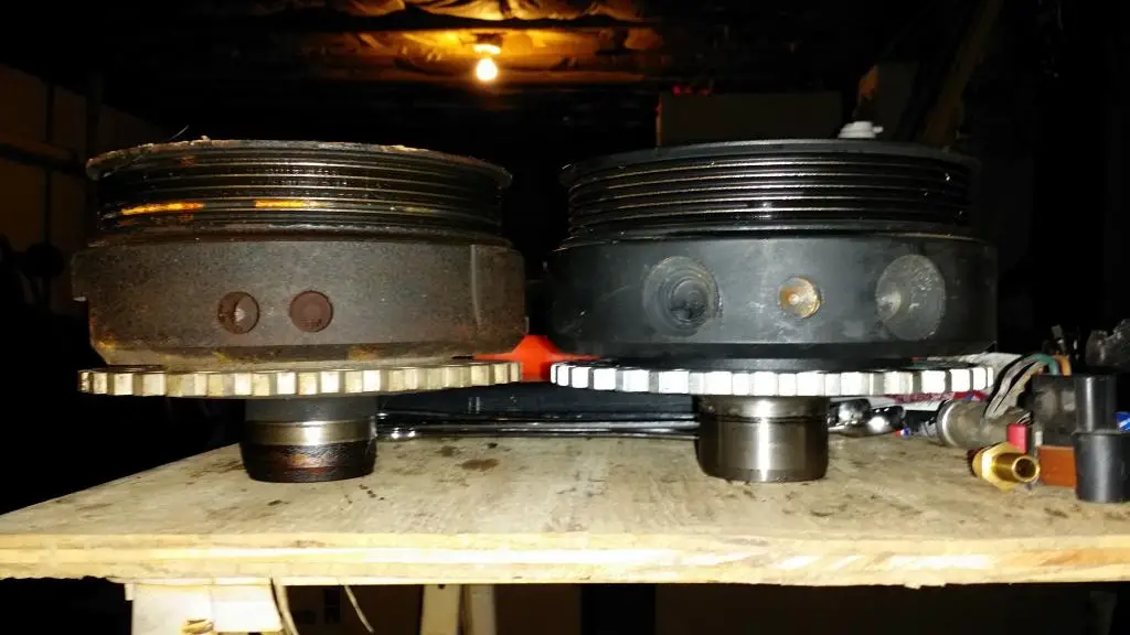

here is a side by side of the stock (left) balancer vs the Damper Dudes 28oz (right)

Damperdudes.com says its tested to 6000 RPM and can handle that occasionally but not for full race.

Is the damper dudes a smaller diameter? It kinda looks like it in the pics, but it could just be the angle.

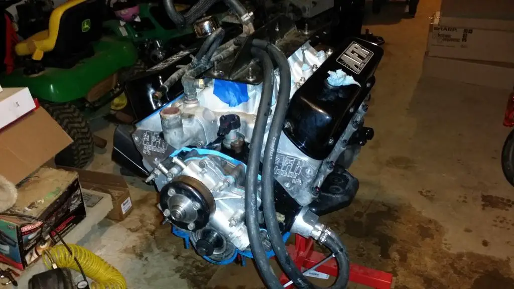

after its put back together with new synchro

That's a nice looking motor. You moved quick on the repair.
I'm betting you will have your truck running by the weekend.
Damper dudes said it's just a stock balancer balanced and shed weight for 28oz. You can see in r he pic the larger wholes drilled to reduce balance weight.

How did you cap off the internal EGR on that Trickflow intake?
I'm asking as you have external EGR, and so do I.
I will be installing a trickflow intake at some point. I can see the hole in one of your pictures of the lower intake. I have not had one in my hands to look at.

The lower is not EGR and the heads are non EGR as well. I didn't have to cap off the port in the upper because there is nothing to lose vacuum to in the lower.
