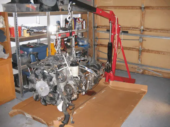

Yes the Harbor Freight hoist SHOULD be able to pull a 4.0L and trans over the radiator support and out of the truck.
I have a Powerbuilt (Cheker Auto special) 1.5 ton hoist I use ($80!!! hahaha it was a floor model and they wanted it gone) I have used it with several drivetrains now, it was able to drop my 5.0L into my BII with 33" tires and a 4" suspension lift, BARELY. :)
The boom that picks up the engine is adjustable for length (also changes the weight from 1.5-.5 ton, as are the legs (for getting around tires, far enough over the engine, etc), with the engine cradle (4 chain thing) and the upper intake removed from the engine you have full control over the position and angle of the drivetrain. I usually stuff these things myself, a 1 man job.
Is there a cummins tool near you? My picker and stand from them was 199 together, 2 ton picker, 1250 # stand.
It seems shipping on this would suck bad.
Any 1.5 ton unit would suffice, I'd say. I'd shop by phone and pick one up locally

If you can do the removal and install in say a weekend, you may be money ahead just renting one,JMO

I bought a two-ton lift at Pep Boys a year or so ago. I forget how much it was but they go on sale from time to time. It was plenty tall and long enough to pull the engine out of my 4wd Navajo, and out of a 99 F150 2wd. I'm glad I bought instead of renting it just because I didn't have to rush trying to pull and drop the engine back in. Plus I always have some project going...

I'm in the middle of putting it in right now. I've got the old engine pulled and am in the middle of transferring parts over to the new one. I have had the usual problems--getting access to the tranny to engine bolts, and dealing with rusted & seized stuff. The only thing specific to the explorer/navajo that I have run in to was a bit tricky getting the engine past the A/C lines because I didn't want to discharge the AC.
Tomorrow or next weekend a friend is going to come over and help me drop the other engine in. I'm sure it will be a pain to get the torque convertor lined up and then again fight with the engine to trans bolts.
