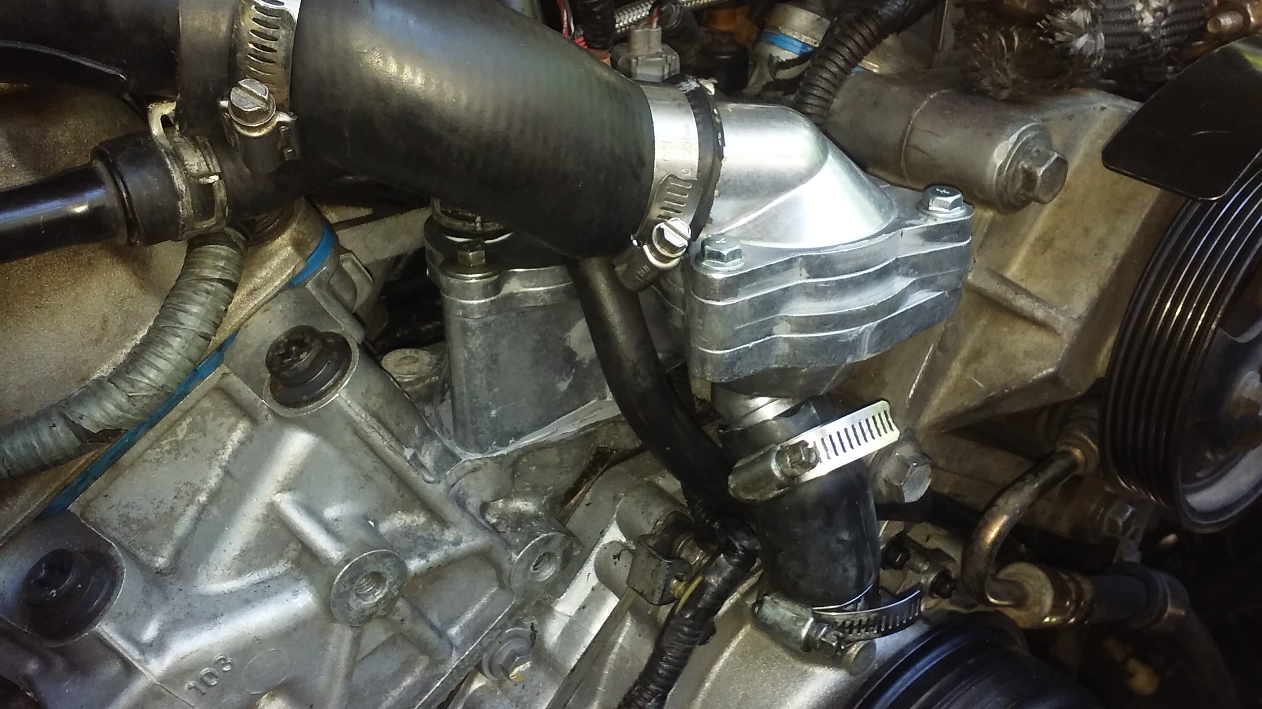

So I ordered one the 2 piece one
Installed it didn't use the thermostat China crap or the lower housing bolts that came with it had no markings so I reused the ford ones
I rtv d the lower housing together let it sit for a day I also used a felpro lower gasket and upper
Installed it today
We shall see if it leaks
People told me the top would not fit so I had to try all I had to do was rotate the hose I little bit fit great

Still going strong
It's so nice to open the hood and not smell coolant

I used the original gasket in between the housing where it's split but I also used water pump /thermostat housing rtv
I don't think it will leak anytime soon
I didn't buy the Simmons because frankly I don't want to spend $ 150 on it
This was kinda an experiment I have had so much problems with the plastic ones
But this one is nice and the machine finishing is nicer than the Simmons the casting looks cleaner
and the way I rtv ed it together was clean
Now don't get me wrong the Simmons is nicer because it's one piece but price to high for me
To just be experimenting with
