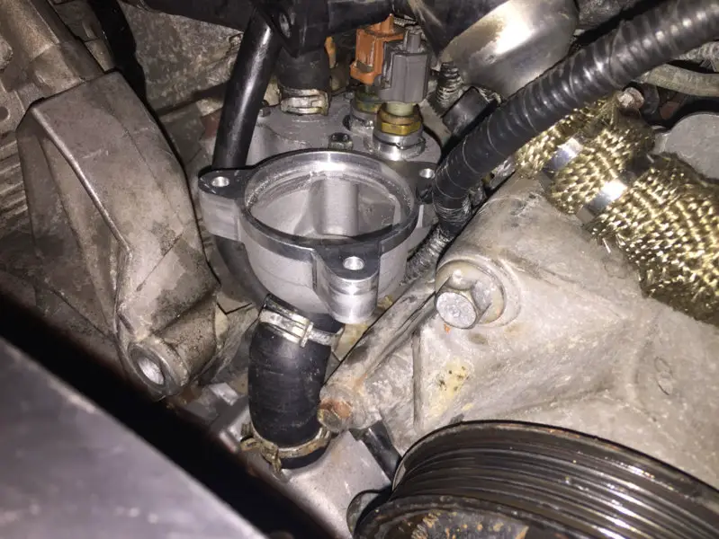

I pulled the leaking Austekk housing and installed the one piece Simmons housing. I believe this will cure the leaking thermostat housing once and for all.
