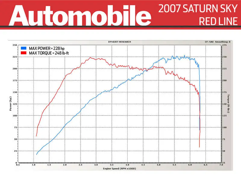

A chassis dynomometer, or dyno's as the slang term goes, is used to show where the horsepower and torque patterns are in an rpm range using (hopefully) a 1:1 gear ratio, usally run it 3rd or 4th gear pending on what's closer to a 1:1 ratio, and the opterator will normally start the "run" at 3k rpms to rediline or what the customer specify's, same with the starting point if it can be applicable (usally manual transmission, as an automtic will down shift to the next lowest gear).
Ah which brings us to "Passing Gears", in your automatic transmission there are 4 or 5 gears, baised on which transmission you have, when you step on the gas to pass, baised on caculated engine load, vehicle speed, rpm's, and the gear the transmission is currently in, the computer may command the trans mission to down shift one or two gear to give ratio of grearing for what the compter thinks you trying to accomplish (rashionality/control strategy), there is not a mystical "passing gear" that it shifts into, sorry.
And releasing a depressing the gas so to speak as you mentioned, it quite hard on the transmission, these ARE the weakest links of these vehcles, and not too cheap to have worked on ;)
In a layman's term:
Torque, is what gets the mass of the vehicle moving.
Horsepower, is how fast it;s going to makeit move.
Looking at a dyno sheet will let you know where the torque come into pay and how fast this happens in the rpm band/range.
Same with horsepower, but once the horsepower falls off, that's it, spinning the motor past this area/range/or point is worthless, you need to shift 200rpm's before this happens to be effective.
In this case this motor is making max torque at 2700rpms and slowly tappers off, max horsepower is at 5750rpms, to be effective in a drag race he would need to be shifting at around 5500rpm's or just slightly sooner.

The only thing I can tell you is the theory you have for shifting may be a little off - Let me explain...
Another layman’s term of torque and HP....
Torque = the amount of force applied to make something ‘work’.
HP = the amount of ‘work’ done over time.
Everyone should understand that HP is calculated by torque. The formula for rotating objects is very easy – HP = (Torque * RPM) / 5252
So back to the shift point theory – You can’t just look a dyno chart alone and figure out where you should optimally shift; you also have to know where the RPM will be once you shift. If your optimal shift RPM causes the engine to dip down too low then this is not the Optimal shift point. Again, you want the engine to be in its “Maximum HP output” as much as possible. That MAY prompt you to make shift points in spots where the HP is actually starting to take a nose dive. The reason for this is because even when the HP is lower than it was 100 RPM’s ago, you’ll still be getting more work done over time once the tranny completely shifts as compared to if you would have shifted earlier.
I hope that makes sense to everyone.
Most of the dyno charts you'll find on the net are calculated RearWheelHorsePower. This is actually a very good pc of data to have. After that you need the weight of the vehicle and you can predict how fast or quick it will be. But, because that is so complicated to get correct the best thing to do is get rear world results.
