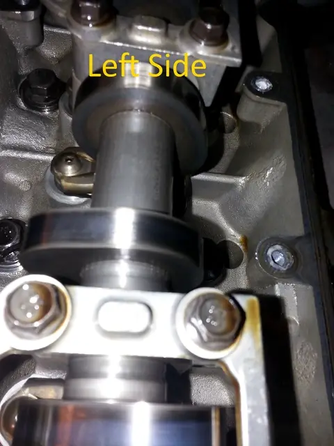

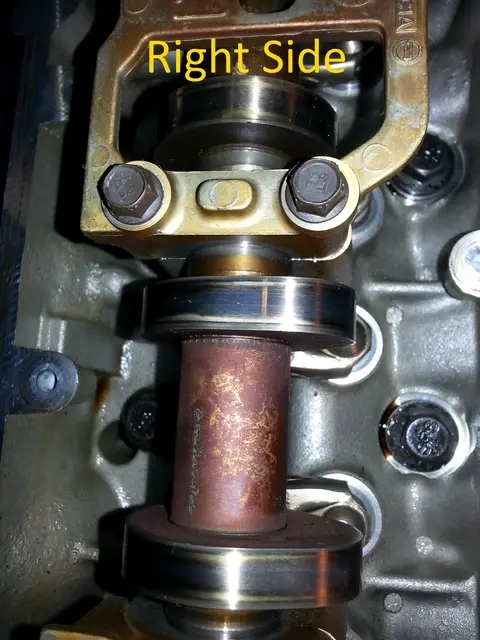

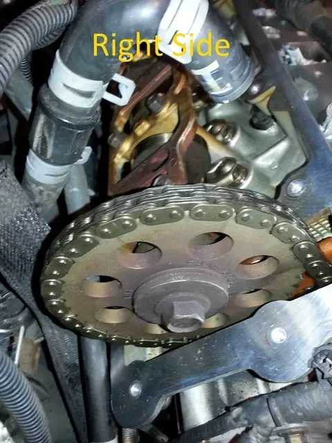

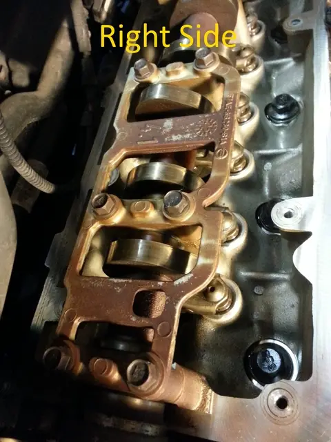

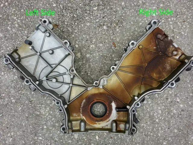

I've got the valve covers off and the timing chain cover off and I'm pondering why it is that the right side valves are golden brown color whereas the left side they are still silver color like new. I was thinking it's pretty weird and my concern is that there's something wrong with what I'm seeing. However, using THIS VIDEO as a guide I noted the vehicle being worked (2003 Mountainer) on also exhibits the same discoloration. In THIS POINT in the video you can see the right side is covered in a golden brown film whereas at THIS POINT in the video you can see the left side is shiny silver. This is exactly what I discovered on my engine.
My theory is that either these engines run hotter of the right side or more likely this has to do with the fact that the PCV valve is located on the right side valve cover and it is drawing the hot gases containing gunk to be cycled back for combustion and it is the hot gas gunk causing the discoloration. Below are pics from my engine. What is your explanation as to what is causing this on the 4.6L V8?
