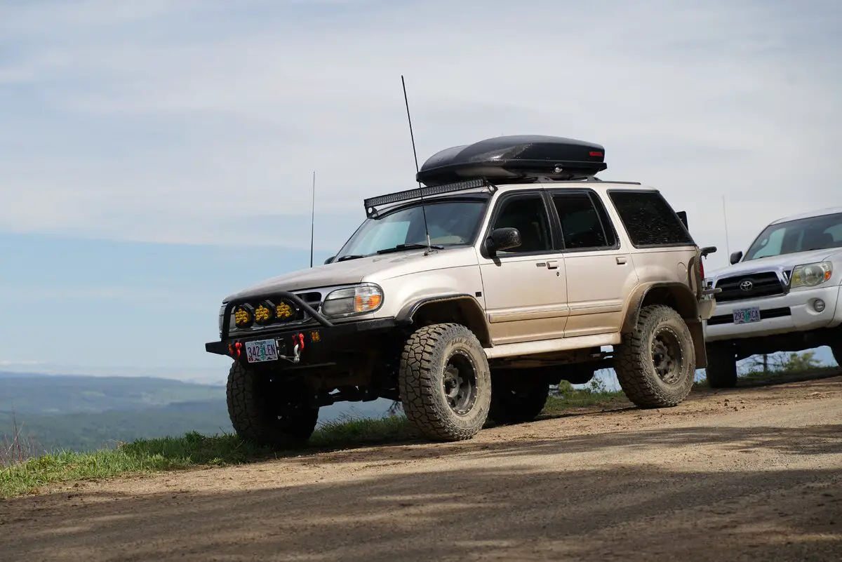

Just to update things on my end I ended up taking my axle to a shop up here in the Portland area and was able to resolve my vibration and cv book explosion issue . Turns out the vibration was caused by a piece of plastic that had gotten lodged in the cv during assembly. They were able to clean it up and rebuild it at a minimal cost. After that I installed it and took it on a few small drives around town and then the 100 mile round trip to my mothers with no issues.
Feeling confident I rolled the dice and me and another buddy took off on a 642 mile mostly forest road trip through the mountains in the pacific NW. The only issue I had was I noticed I had developed a small leak in my transfer case rear seal.
I'll call that a success!
Pics to be uploaded soon!
