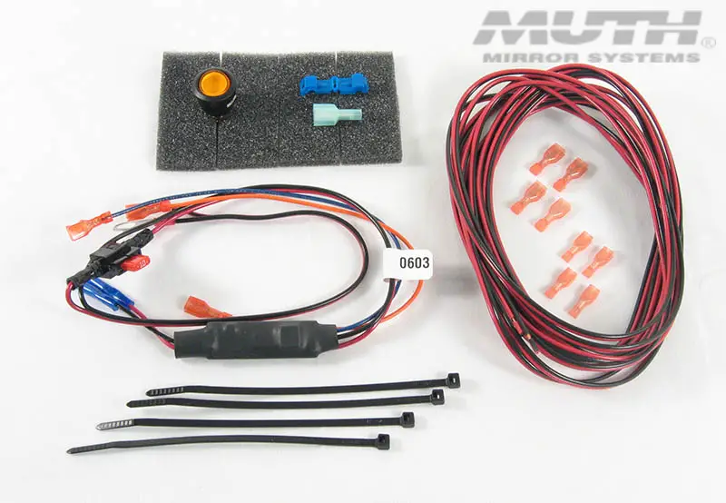

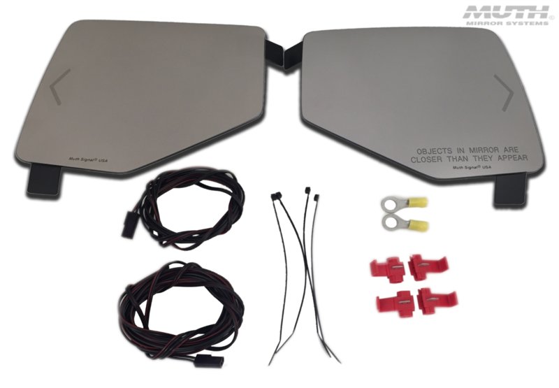

Heated signal mirrors with red signal

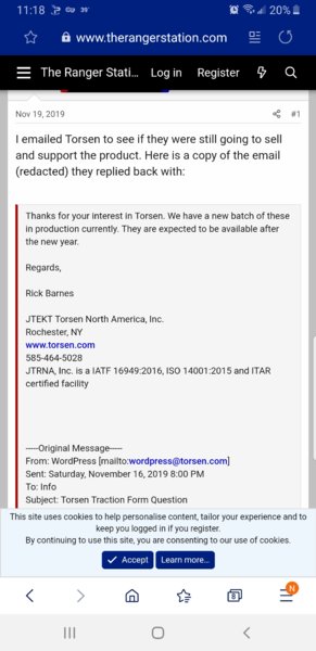

I couldn't find a select-able for the SLA D35 at all. I was told that ARB doesn't offer them, and I couldn't find one for OX either. Torsen LS is my only option other than a lunchbox ( currently installed), for a mechanical unit. If you find out different on these lockers, please share!!!

The special axle snap ring is what makes the Explorer D35 so special, in a bad way. I think only a high end rear end builder could do something with the odd parts(make something from a normal D35 go in there). I doubt there's enough interest to motivate any place like Currie etc. The Torsen will be good for me if it doesn't cause too much pushing in the snow, on slick roads.
