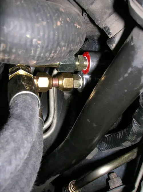

The stock oil filter for the 5.0L is behind the radiator on the drivers side, so I only had to use very little hose, in a "U" shape. In order to get proper clearance, and a smooth curve on the hose, I used 90 degree adapters on both the engine side, and the bypass filter block. I ordered the first pair of 90 degree fittings from Amsoil ( actually had them lying around from doing this same install on my wife's 92 Lexus ES300 ), which cost $31.25 (Dead Link Removed). After mocking everything up, I realized I needed another set of 90 degree fittings, and I also realized that these are simply 1/2" 45degree flare fittings. So I bought some fittings from a plumbing supply store to the tune of about $10.

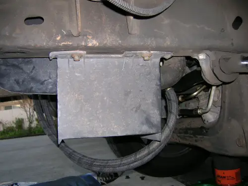

The hoses do hang slightly below the radiator, though I don't foresee them being a problem since this is a 2wd, and I do not offroad. In the future I plan to get an Explorer Express front air dam which I trust will hang down farther than the hoses do anyway.

The engine side mount just behind the radiator, and above the front anti-sway bar.

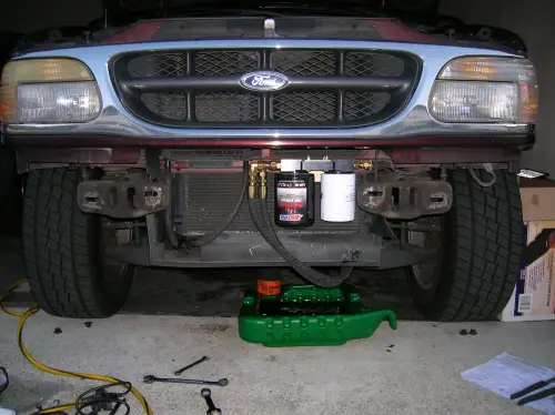

The view from the front of the vehicle with the filters installed.

A view of how much (or how little, in my opinion) the hoses droop below the radiator.

Nice job. I wish I had the mechanical smarts to do a similar install on my 5.0. That low hanging hose does look sort of scary, though.

As for the hoses, yeah, they do hang a bit low, but I don't expect they'll ever come in contact with anything. As it is I've done plenty of hard street driving since the install, and they haven't been a problem.

Nice , clean install; you are gonna love it.

So is there enough clearance to remove the filters from between the radiator and bumper, or am I imagining it?

No problems at all changing the filters.I'll cover the filter with a loose plastic bag {to catch the drips} after I've loosened them.
