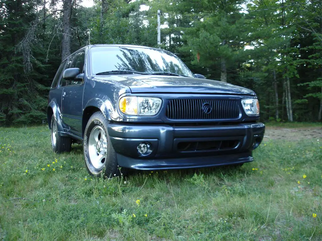

This is what it looks like now. Before I had cut and painted over a factory chrome grille. Now I am running a factory painted blue grille from a salvage yard. The paint wasn't perfect on it but it is good enough for me right now and the color matches so I left it.
how do i find a billet grille for mine like yours has on it now? or any kind of other aftermarket grilles. i really dont like the look of the vertical grille on it. i want (if possible) a horizontal billet grille.
The new mounty v8 sport limited!! That front end is perfection. I want one!! :)

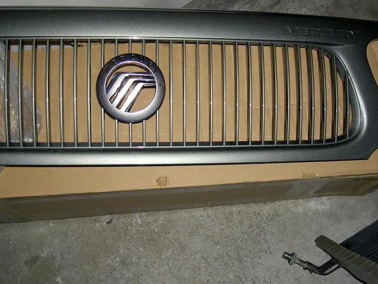

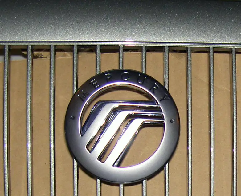

Eric's truck is beautiful. Get one of the 2000 or 2001 Mountaineer non chrome grilles like his. I have a 2002+ Mountaineer emblem to make fit into mine, I like the design and color a little better.
I'll have to grab a grille like that for a future mod. Thanks!
Those are the only two factory colors it came in, for the two years. I'd bet there are many in salvage yards now. Go at it.
