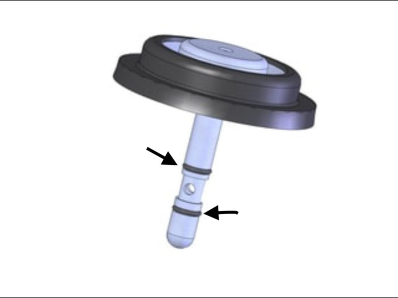

The replacement upgraded servos use a green o ring. These are what I was referring to.
Lol, gotcha, you meant the "modified" servos. Okay, another stupid question... where do the o-rings go? I don't recall seeing them on the servos themselves when I installed them, maybe I need to pull them out and see which one was sheared off. I remember reading in the install instructions that you have to get the servo in right the first time or you risk damaging an o-ring. I assumed they meant the larger diameter black o-ring that goes around the servo cap.
Here you go.
