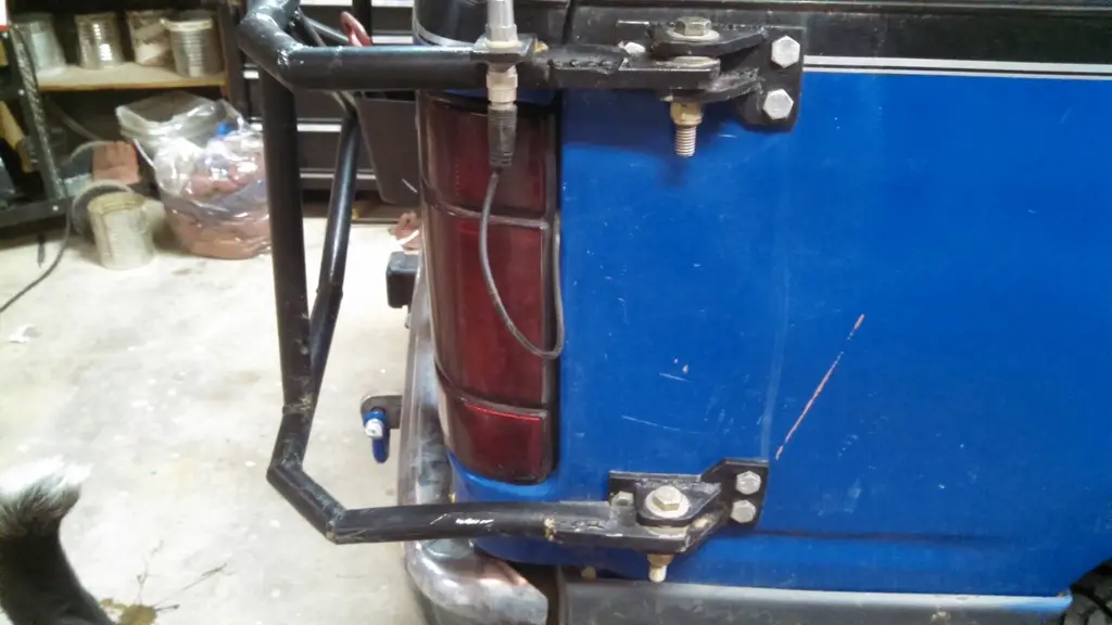

The tire carrier I built myself...the tubing is about 3/4"-1" pipe from a buried propane line we dug up and discarded, ends came from a trailer hitch on an '89 Dodge van, the mount on the back hatch came from the same van (one of the mounts for the rear bumper), lugs from an old rotor for the Explorer, the hinges mounted to the body and the plate the lugs are welded to from a 1/4" plate used as a base stand for a sign. Everything I needed and used other than the bolts used for mounting and the hitch pin came from the scrap pile here at the school...the bolts I picked up at the hardware store.
The gate does bounce up every so often down the road...I plan on welding an "upper plate" to the mount on the rear hatch to handle that. The body was reinforced using electrical box covers fully welded to the body where the hinge bolts passed through. Seems to hold pretty good, but with every thing I've fabricated myself, I see flaws in it and want to do all over again lol.

[MENTION=277923]worms92explorer[/MENTION], here are some pics of the tire carrier.

I will say that I'd do it over again if I could, and this time use a pipe bender on the steel rather than cutting it and welding it back together...I'm sure it'd be stronger if it hadn't been cut and welded at each corner. It has some flex to it, so I might be adding in another brace before Moab....might. I'll be remaking the entire thing after I make a new rear bumper...though, it'll be in a few years more than likely lol.
I will say that I'd do it over again if I could, and this time use a pipe bender on the steel rather than cutting it and welding it back together...I'm sure it'd be stronger if it hadn't been cut and welded at each corner. It has some flex to it, so I might be adding in another brace before Moab....might. I'll be remaking the entire thing after I make a new rear bumper...though, it'll be in a few years more than likely lol.[/QUOTE]

It has been done before. However, you have to make sure that you use some bracing where the rack bolts to the body. The factory stuff is ok, but it is worth improving.
