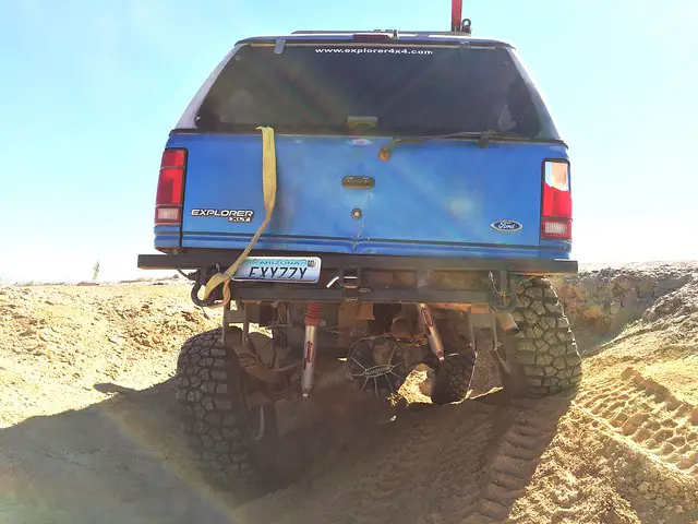

As for the sway bar.. Well, while I don't run it, some people do and it does make a difference on road. Off-road it will make a difference too. There is no way I'd be able to get this kind of flex if I had my rear sway bar on. If your going to put it on, take it off when wheeling.
