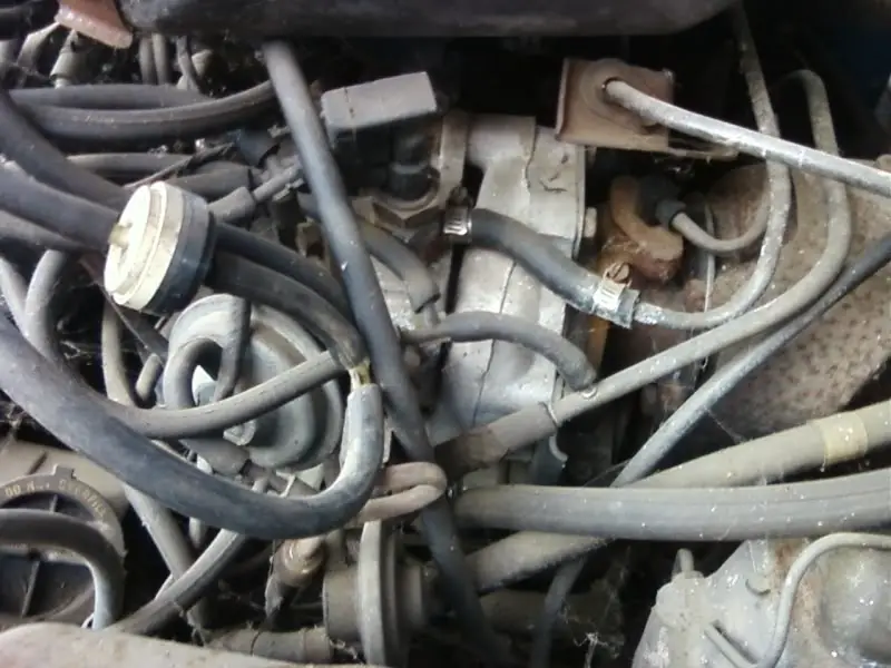

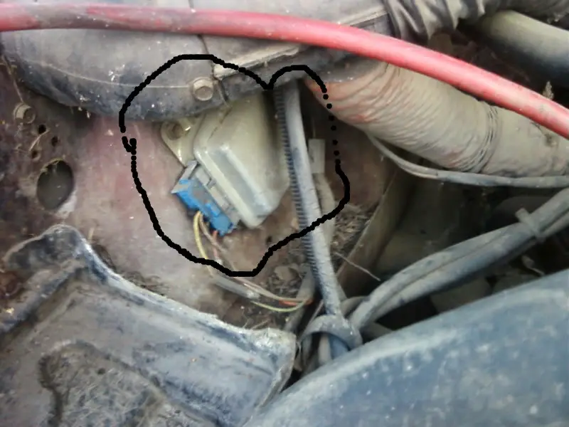

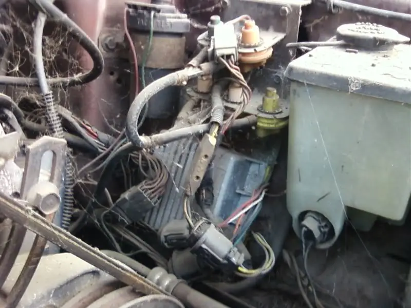

well heres some pics! the first two have some Items I need identified. I'm not sure what i'm looking at!
whats this? VOLTAGE REGULATOR
(Directly behind battery compartment; pass. side
or any of this?SILVER SQUARE BOX IS IGNITION MODUAL, BLACK ROUND THING IS THE IGNITION COIL, ORANGE, PINK AND YELLOW ARE THE ELECTRONIC VACUUM SOLENOIDS
(Behind coolant/wiper res.; Drivers side)

in the first pic, if i am not wrong is your voltage regulator. in the second, is your ignition box. and in your third pic if i am not wrong is the turbo that no one can see! :D

would there happen to be any service manuals or anything that diagrams how the turbo and associated items are plumbed? it would be nice to match a "road-map" to the metal jellyfish. also a wiring schematic/diagram would be AMAZING!!!!
if not readily available, I have no problem purchasing one.
I'll have to do some digging, but I prolly have something.

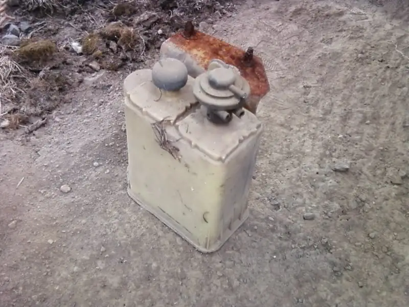

I have the car on jackstands, wheels are in storage. I raked and swept the dirt away underneath the car. there was a good two inches of soil on top of the asphalt that had run down from the road over the years. I killed 3 more wasp nests. I took all the stuff out of the back of it. its starting to look like a car again! :p: I bought oil and filter. my Grandpa has a filter relocator at his shop somewhere. I hear those filters are a pita. I also got an air filter and I still need to get a fuel filter. once I get the remote filter kit, I'll change the oil and clean the fuel tank. I'm gonna dump it, rinse it with paint thinner, rinse it well with water, let it dry for a few days, rinse it once more with denatured alcohol and fill it up! After those two criteria are met, I still need to replace the vacuum resevior. it sits under the battery which leaked and now theres a bunch of cancer there. the connector for the resevoir got eated as did the passenger sife frame horn. :rolleyes: oh well, its 30 years old, it had to have SOME kind of damage, right? after that, and new vacuum lines, I think I can fire it up for real! oh, and it still needs a thorough cleaning.
You'll probably have to rebuild the carb too.
That should be the evap emission's canister under the battery, black, square/rectangular.
Take a picture of it, I may have an extra one around here.
Jeff - :navajo:

and just a sec on the pic of the broken part
oh and I've registered on the FEP forums. been askin' questions and doin' some heavy reading
I think monday or tuesday me and a friend are gonna pull that fuel tank, get it cleaned, and change the oil. after that, its gonna get a full detail. inside, outside, underneath. it will be IMMACULATE!! once I get the random box replaced and the cancer cleaned up, it should just need new brakes wheels and tires to be drivable!
this winter I'm going to pull the whole thing apart, body work, paint, the whole nine yards. until then, I can still have some fun with it in the shape its in now :cool:
In regards to that broken box, I think all I really need is the big rubber connector that the vacuum lines connected to. I'll also need to find some sort of diagram that'll show me what vac lines go where :scratch: Its time to invest in a Haynes manual
