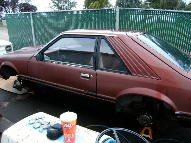

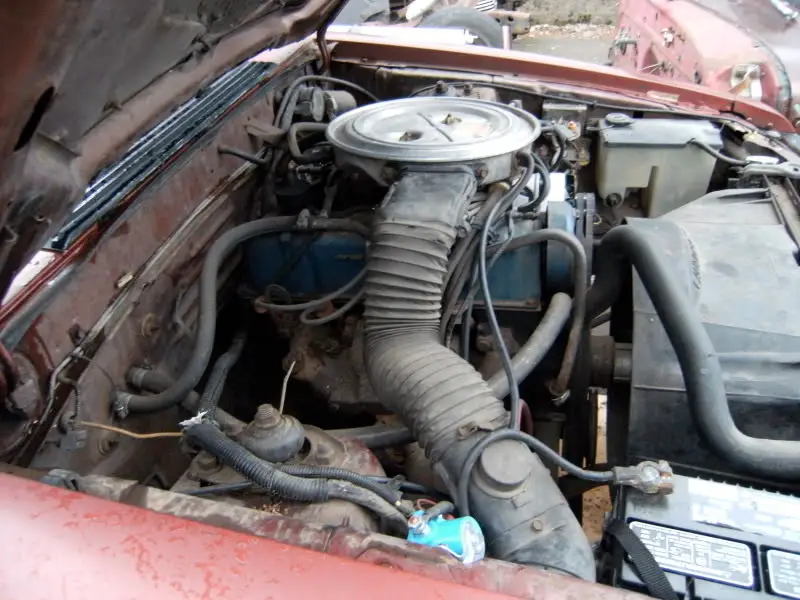

Uggh! poor car, well I saved it, but it's had a bit of a worn life, it clocked almost 180+k miles, it's looking more like an "L" and not a "GL" model.
In 1982 there weren't split fold rear seats it's a 3.3 (200cid) straight sixxer, or small block six, especially compared to the 4.9 I have in my Flareside.

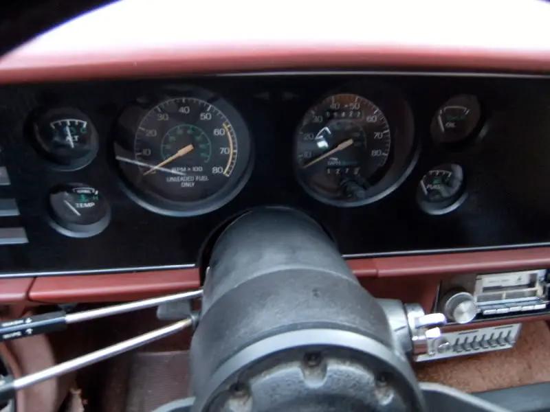

It runs but needs a tune up, all of it is there except for the smog pump and diverter valve which I have both, the interior well I'll let the picture speak for that, it does have the sport steering wheel in it and intermittent wipers, all the body panels are original, and has never been in a major wreck, there is a small dent on the deck lid and one by the gas door.
the car is clean on the under side with no rust, even in the typical spots, although upon closer inspection, the sun roof has a little around it, and the bag for the sun roof is in really nice shape, nicer than the whole car.
He gave me an extra tail lamp assy for the broken one, they hacked the dash to put an aftermarket radio in it :( the front and rear bumper covers are torn and need to be replaced, headlamp switch is missing, but other than that it's all there, and not too bad for the life it's had.
AND it has the factory Ford rear window louvers!!

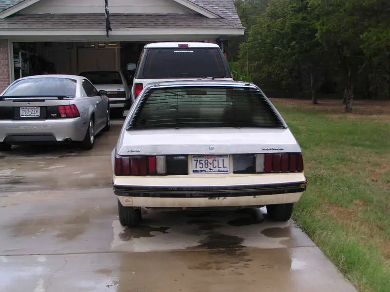

well "I" feel left out, so "I" will post pictures of my find!
83 merc capri for the wallet breaking price of $250 canadian! (hey i live in canada, so what can i say :D)
general lee faded orange
i hate bubble backs to, but 83 was the year they changed to them. ford/mercury is allowed a brain fart too every once and a while.
oh, it has the poop brown interior to! :thumbsup: what a color combo
and who can forget the ever more powerful......what 90 (on a good day) horse power 2.3L NON turbo! but it dose have a 4spd in it.

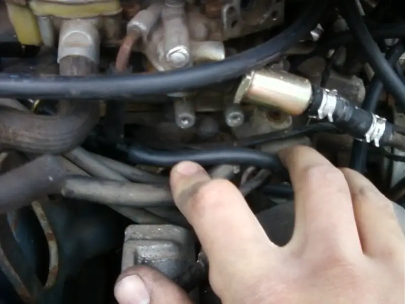

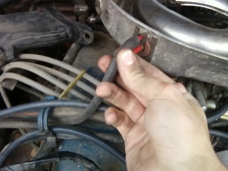

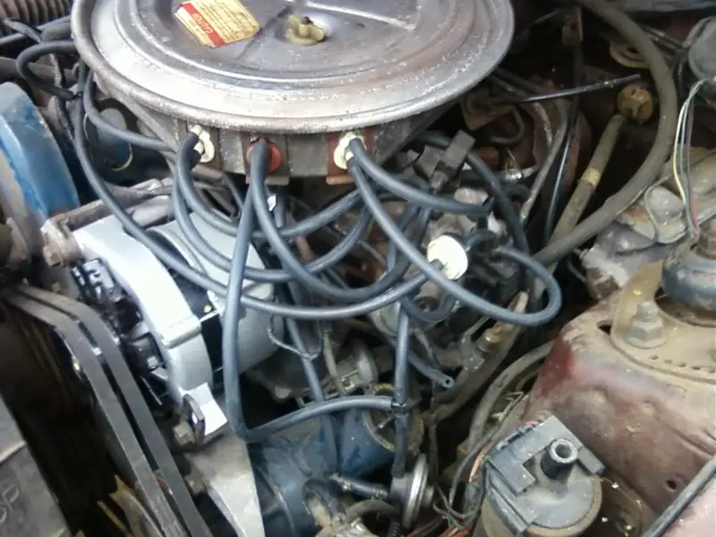

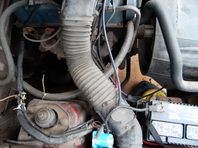

I gots some new pics:

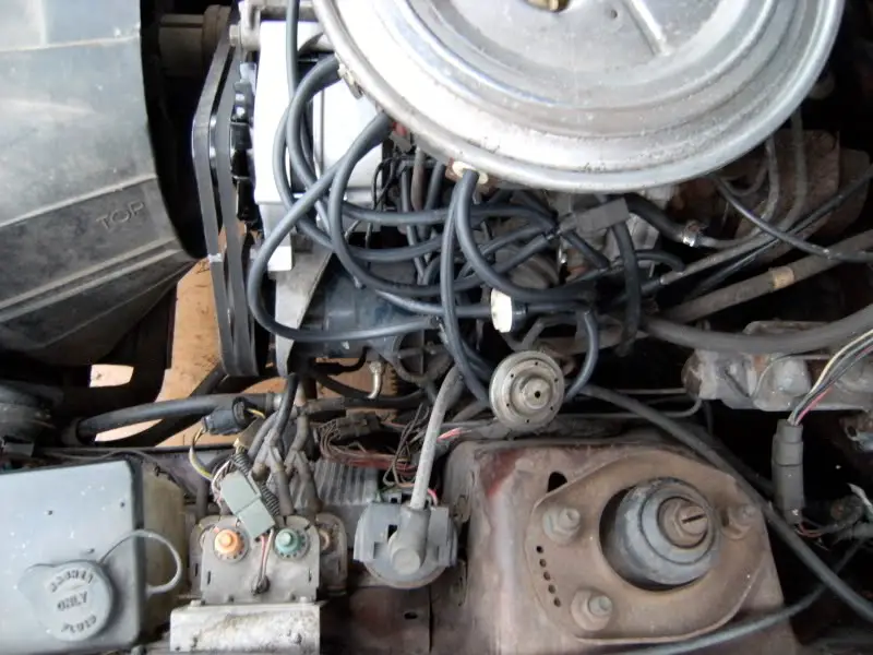

the new vacuum lines
although I don't know if this is supposed to be like this. are those plugs or broken connections?
this is where they go
here:
and down here, vacuum tree?

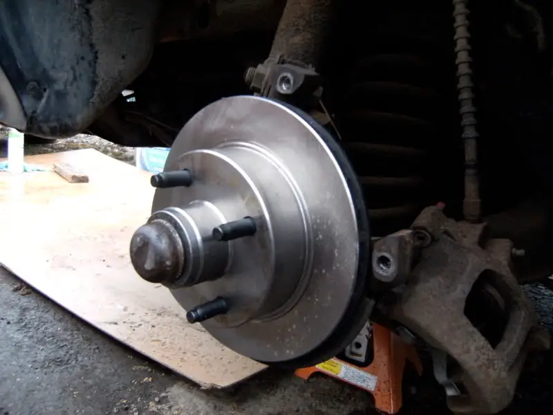

ok boys, I took the plunge. ordered new rotors and bearings and seals. they'll be in tomorrow.

while your doing your brakes, look at the rubber houses that your calipers are HANGING FROM!!!! :nono: (that is a no no, but I'm just as guilty as you, I've done it in the past as well). make sure they aren't all cracked up, or look dry roted.
oh, no worries. The only reason they're hanging by them is cuz they're already cracked. as soon as a moved the caliper away from the rotor I saw the crack in the line. so now its a convenient coat hangar

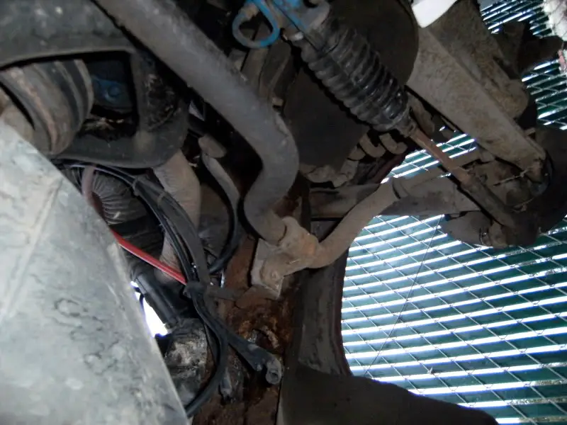

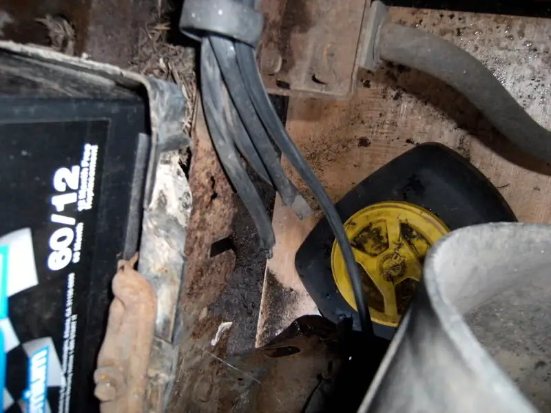

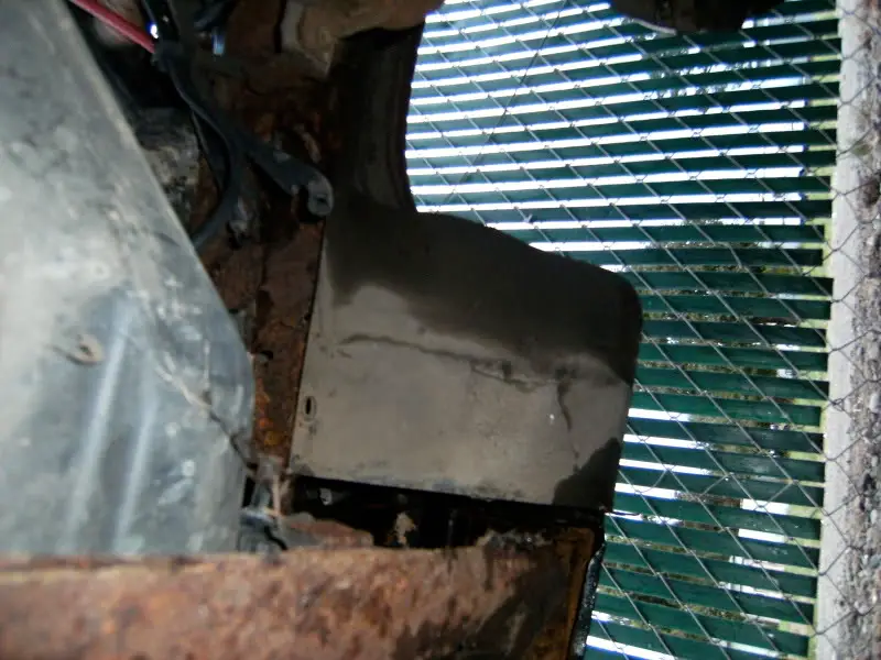

hummmm, lack01, can you take some pictures of where the canister is mounted to the frame of the car? i mean underneath. something doesn't look right. me thinks you might be doing some rust repair.
