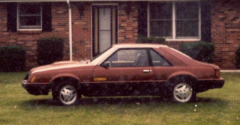

I noticed in the pics it actually looks like he has an after market radio in it already, and yes Ford put out quite a few systems back in the day so probably about 4-5 head units, including 8 Tracks, were optioned back then.

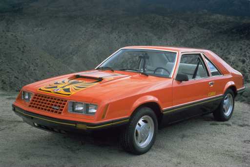

Take a look at this little jewel, this is a late 1979 with, yes a 200cid straight 6, this was the 6 cylinder that replaced the roll-over V-6 found in the 1974-1978 Mustang II which is what we have in our 1979 restoration project, this car although deemed by "Hot Rodder's" as worthless, this car is actually worth a mint!!
I would pay good monies for this car:
It's hard to find them like this any more, there all molested or in salvage yards.
