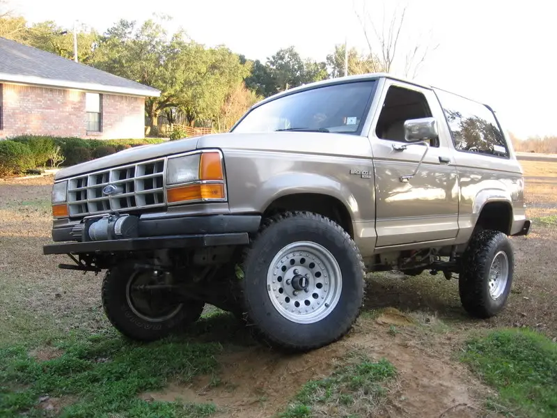

Here it was stock

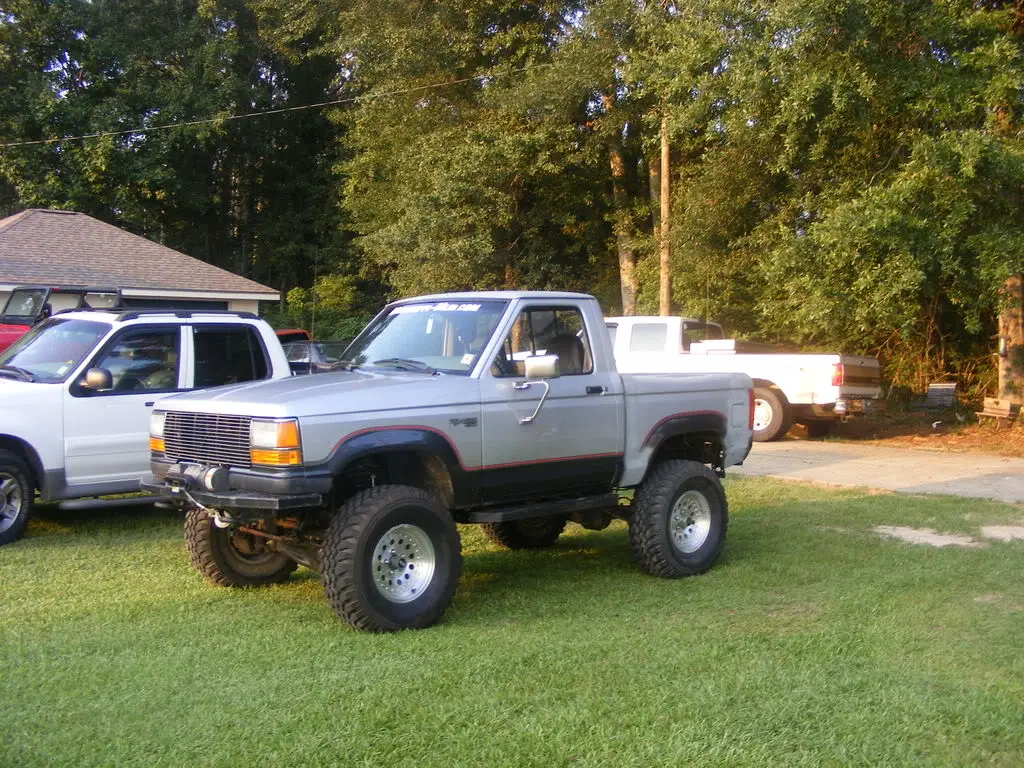

and after

There is alot more rust than meets the eye. The details are rebuilt 2.9/c5/bw1350 t-case. I have a 302 waiting to be put together and put in. It is a rough country 4 inch sus and 2 inch body. The ranger bed has been cut down 13 1/2 inches. I'm 16 and have been working on it since I was 13 or so. So far I have won 2 unfinished car show awards.Thanks Brandon B

Yea it has been great, so far, I have been to tellico twice and moab next summer

Did you pull the bedsides or is it just my imagination?
Ok I will do it. Yes I did take the bedsides off. It was a pain in the butt, and I probly will never do something like this again. I hate not being able to get out what I put in it. Thanks Brandon B.
