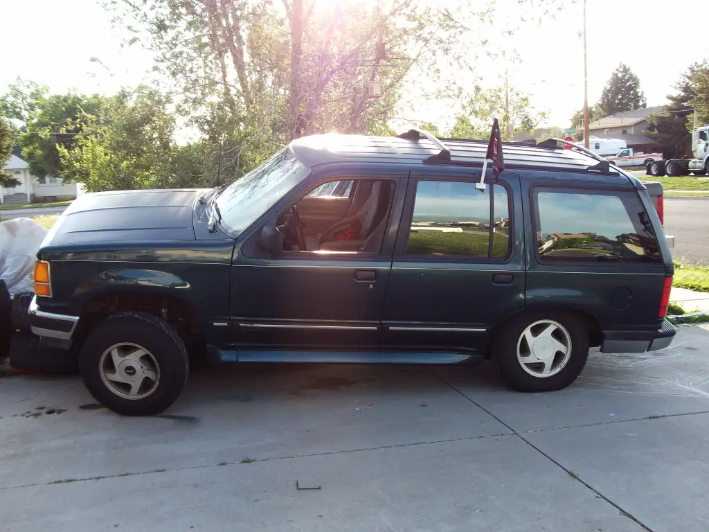

Thanks Naasau i will definately check into those things. I haven't had a chance to take any pictures of my current explorer yet. But i Did find one of my old 91 and its my favorite so here is that
ATTACH]

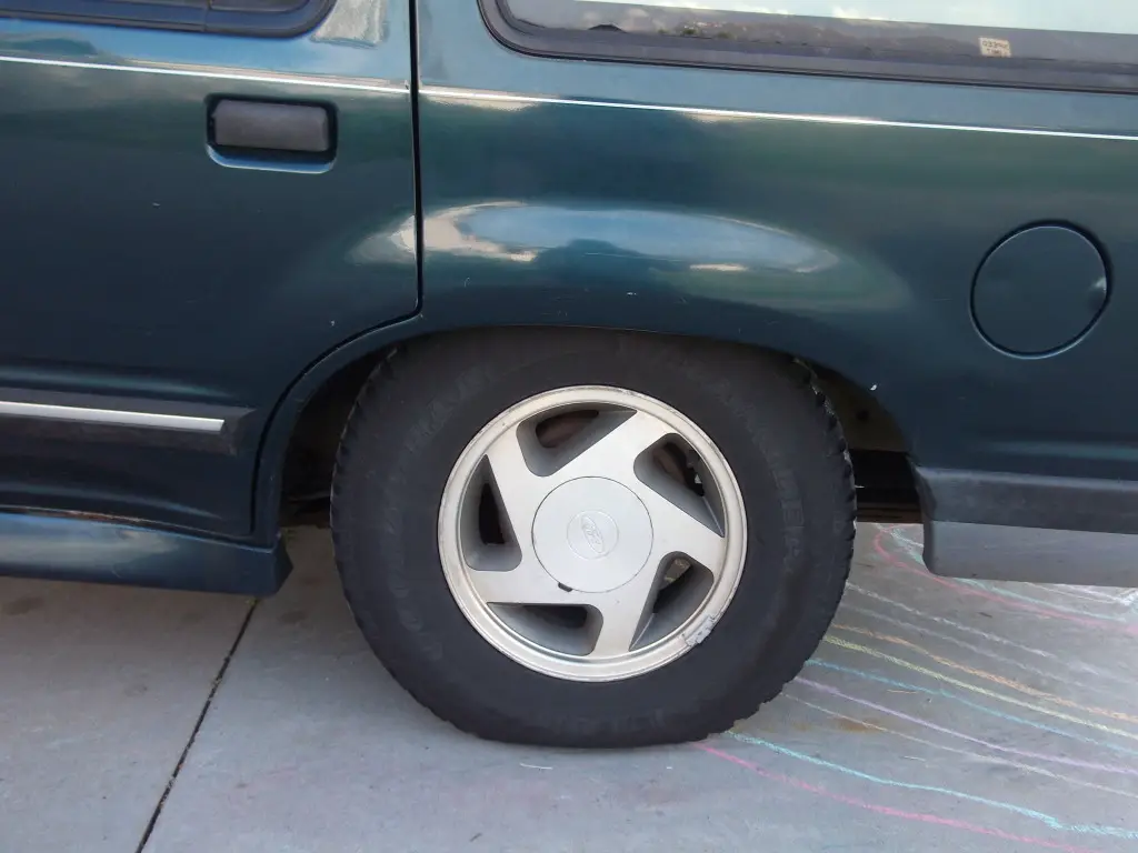

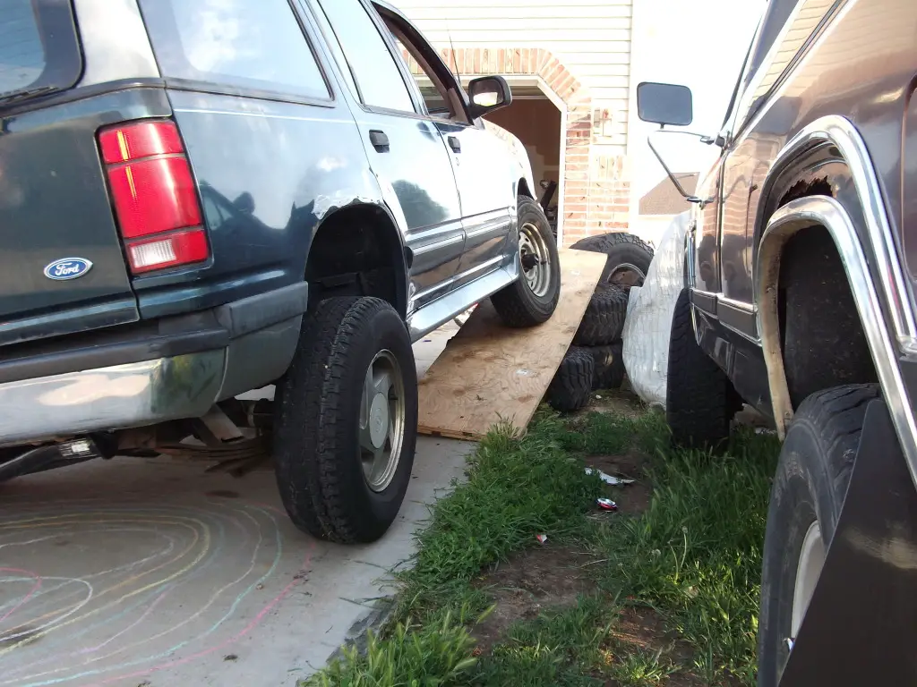

Ok so it isn't the best but here is a few pics with some flex of the current stock explorer..probably should have disconnected the sway bars but it was just a quick pic so not bad but not full potential.... Work begins in one week from today!!!

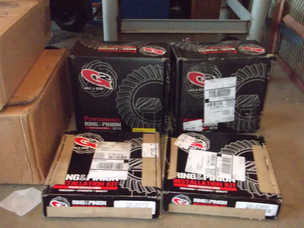

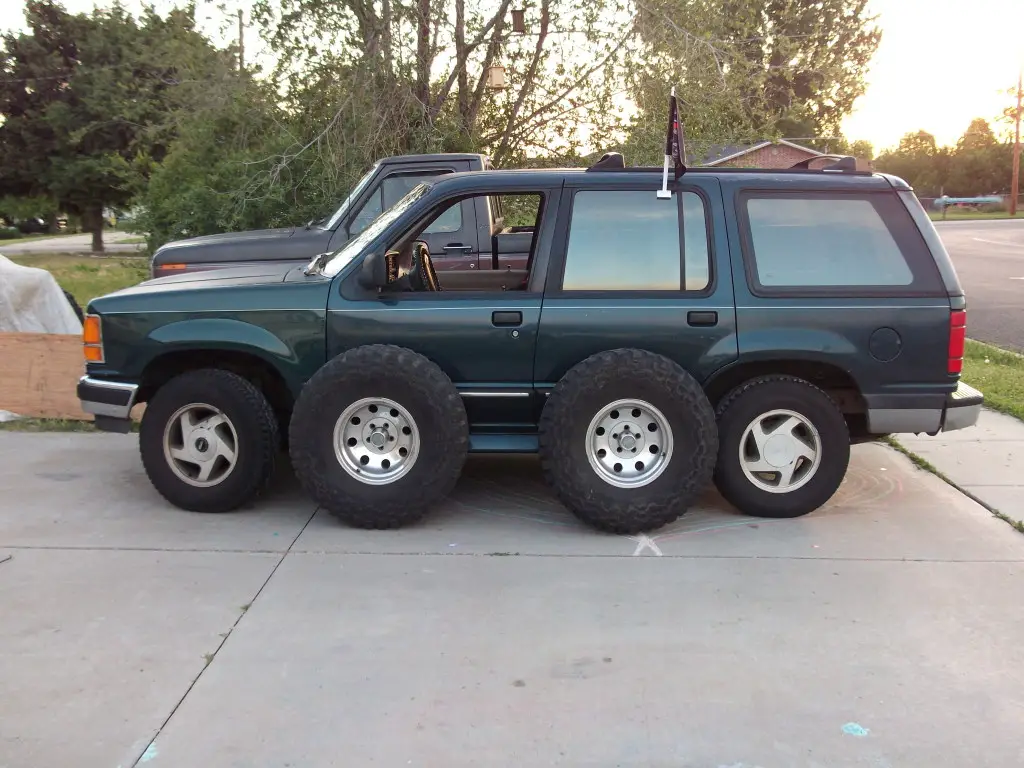

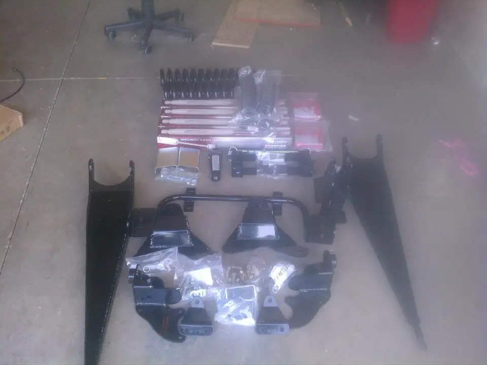

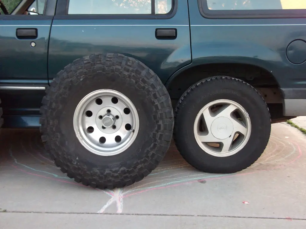

Few more pics i wanted to share showing parts and difference in tires against stock...... I just know i like pictures so i hope they dont get annoying to anyone.

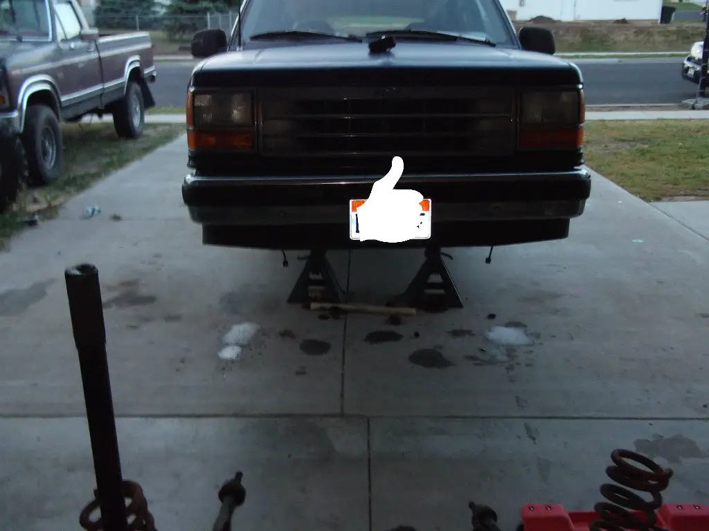

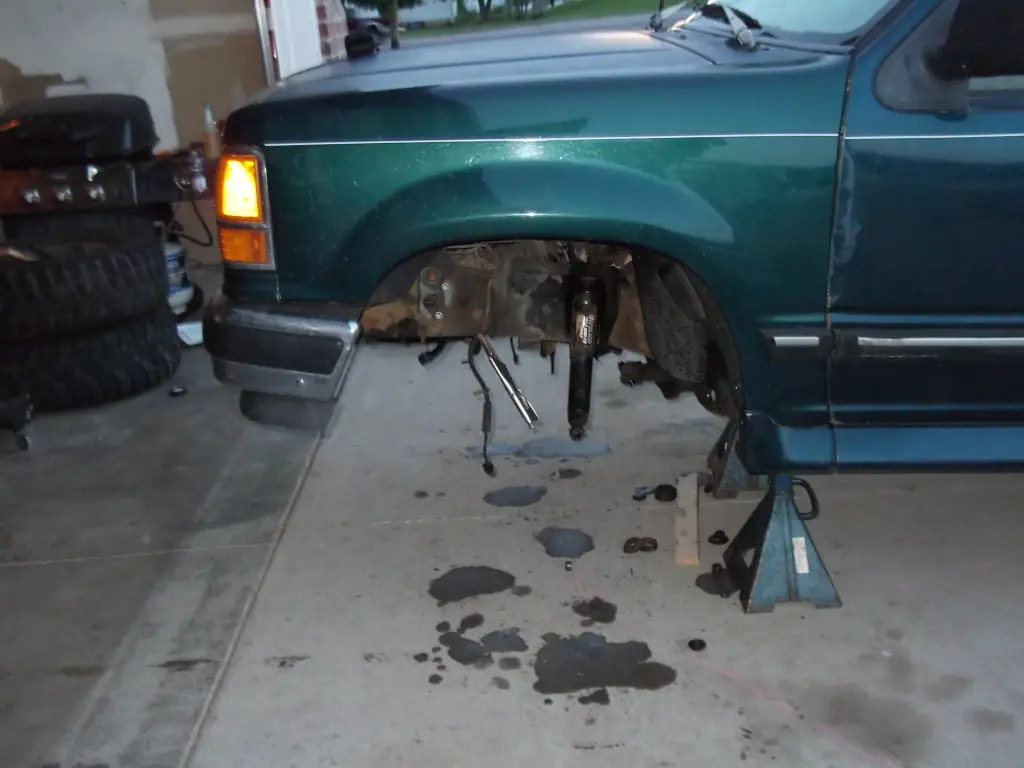

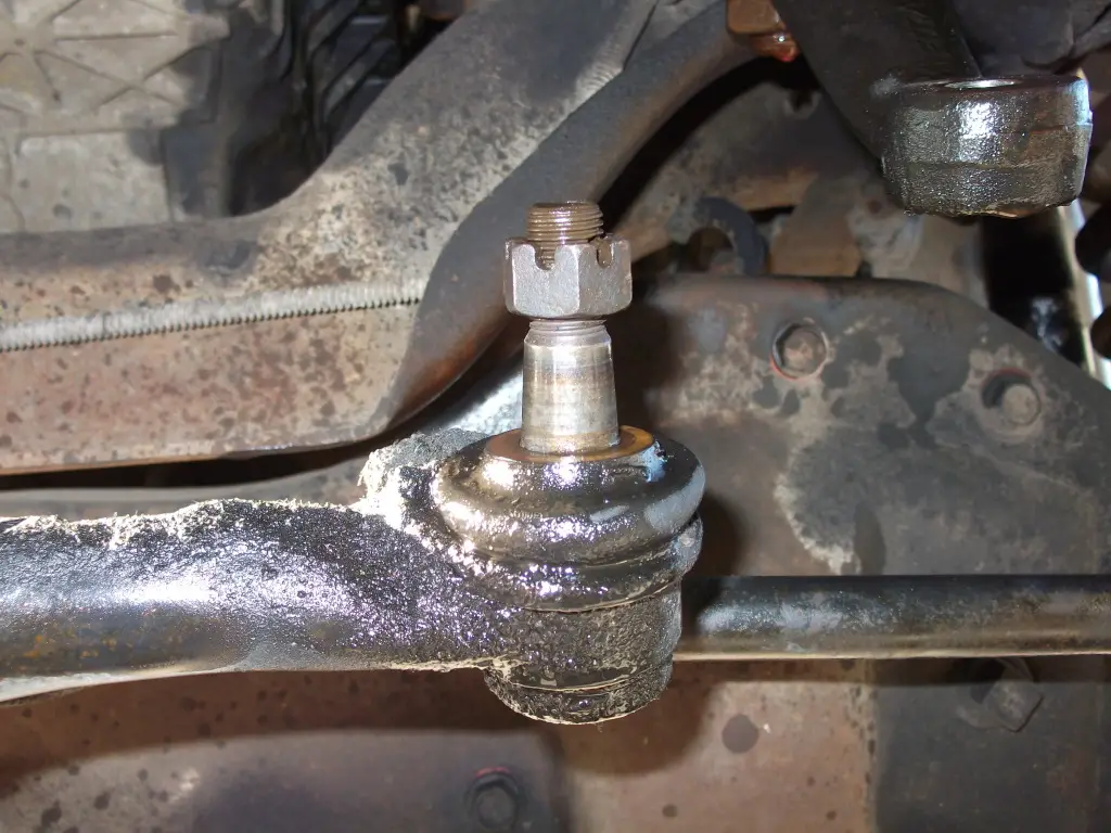

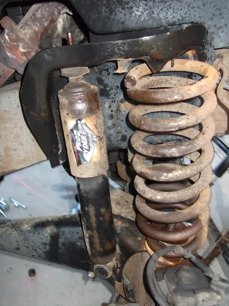

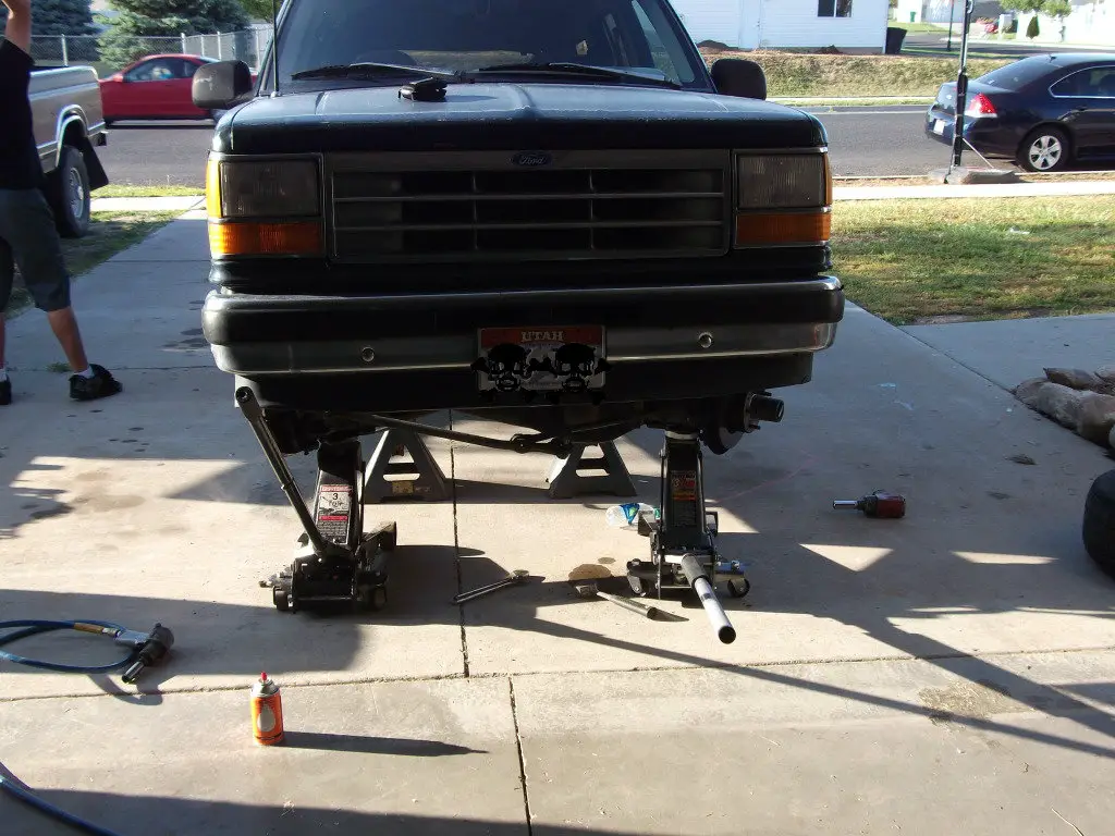

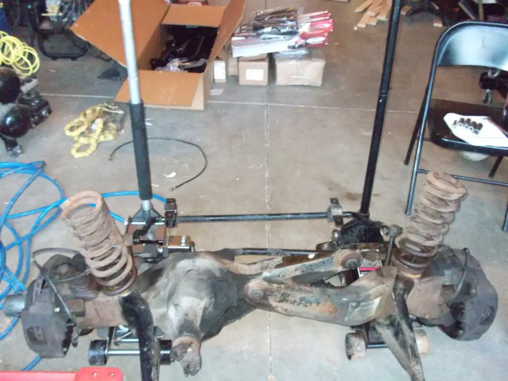

Ok so i was anxious and couldn't wait til tomorrow to start so i figured i had enough daylight after work to get a little start even if it was just getting it on stands and taking the tires off!!!! BUT this is how far i got!!
Its on stands and jacks supporting the front end........
Drag Link disconnected from pitman arm......
Top of coilsprings and bottom of shocks disconnected......
Disconnected the sway bar from the frame. Lowered both jacks a little and took the nut off the back of the radius arms, then worked the front end out from under the truck.
Front end is removed and in the garage then i cleaned up and came in for the night. Pretty good progress i think for like 1.5 hours...

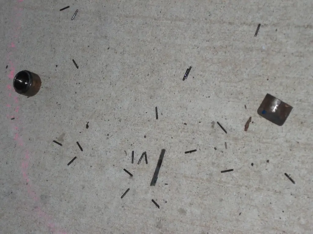

Oh and one mishap i dropped the caps from the u-joint and the needle bearings fell out but i was planning to replace them anyways so...
If anyone wants pictures of anything that i can possibly get as i go or that i may have missed or whatever just try to let me know asap... and any questions that i can try to answer i will but most everyone on here knows WAY more than i do so!!!

Holy crap! The last time I did that it took me twice as long to yank the front end! Very well done!
