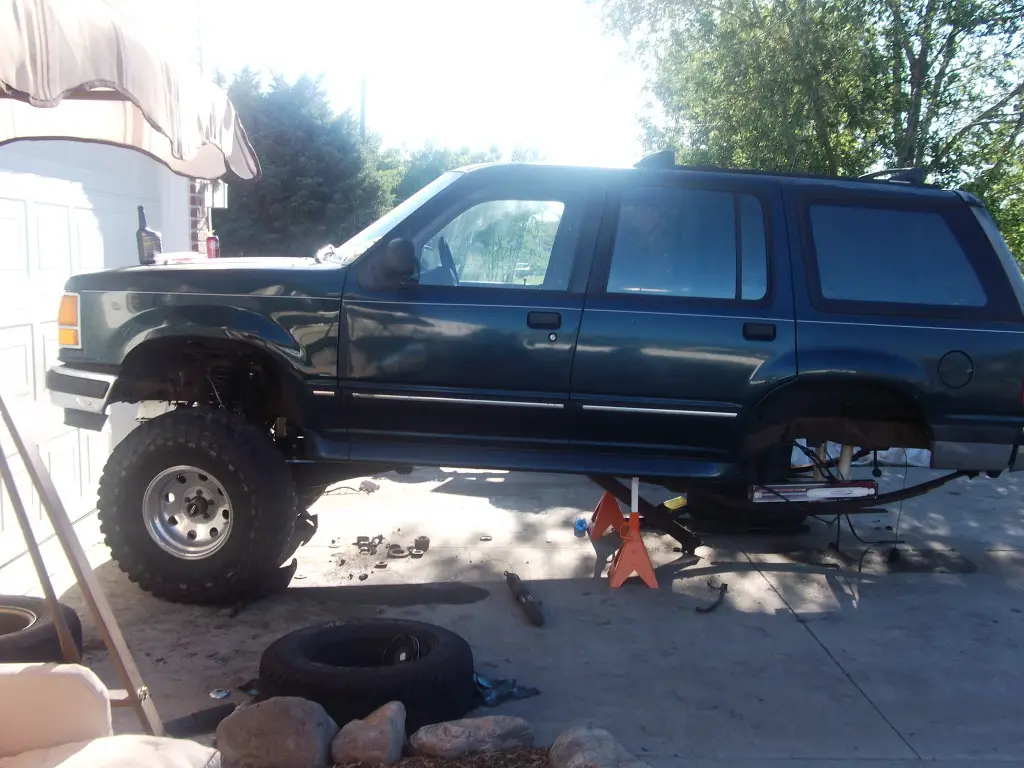

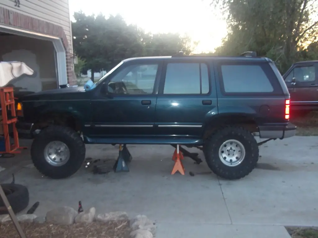

Ok so i didn't get any farther but i did want to show a couple pics. The first one is the mock up picture i took thinking it was at close to the right height and just pushed the tires up there next to it. The second one is after I lifted it up enough and got the front end stuffed. Now obviously it will settle an inch or 2 but notice the amount the front is higher than the rear in the second pic and remember that i didn't move the rear jackstands at all.. I did a couple measurements and will have to lift the rear end about 8 inches to get the axle to roll under it.. I AM STOKED!!! The front of this thing looks BAD @$$ and i cant wait til im done.. anyway here is the pics
Notice how in the first one its on jackstands and almost level???? The second one only the rear is on stands and the front is done just needs to settle in?? but its going to sit way higher than i originally thought and i cant wait its AWESOME!!!!

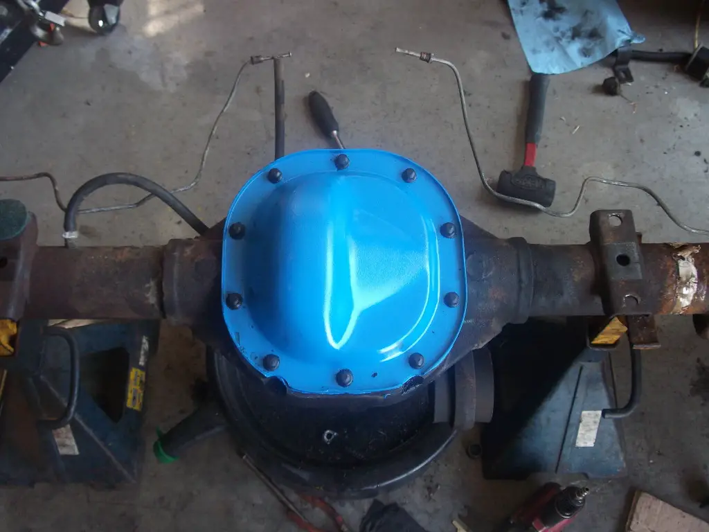

Well i got my setup bearings made for the rear end, cleaned up the diff cover and painted it blue.. Ya its ugly and doesn't match anything!!!!! That cover is going to stick out like a sore thumb lol.. i know im weird. anyway NASCAR was on today and it took precidence over the truck so work tonight and hopefully get some work done on the truck tomorrow!!

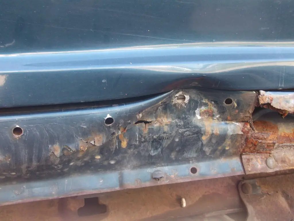

Ok I got the gears done today and the cover back on..... BUT I was going to lift the rear of the truck up so i could extend the jack stands, I had front tires blocked on both sides. Using a high lift jack in the hitch to raise it when i got close to the height i need to be at the truck started shifting!!! And i started ****TING :eek:, long story short IT FELL :thumbdwn:, Jack stand on the drivers side jammed into the bottom of the rear door so yeah damage was done but nothing to slow me down too much lol just gotta purchase a new high lift jack now and i have a plan for tomorrow to get it up that will work great you will see.. Anyway here is a pic of the Rear diff cover and a couple of the damage done....
Looks like it needed to have some rust fixed anyway. Nothing too bad, but sorry to hear about that.

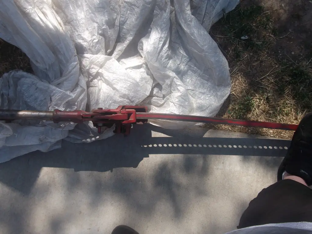

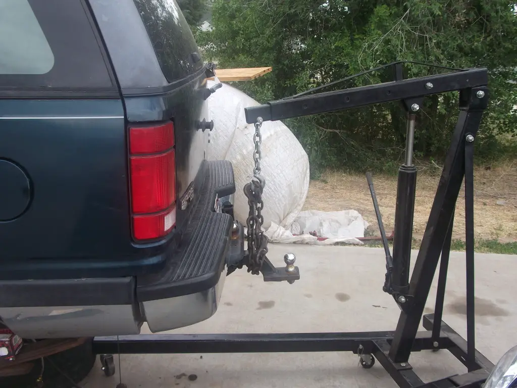

Ok had some pretty crappy weather today but i still got some work done!! First here is the way that i decided to lift the rear end up, and it worked very well..

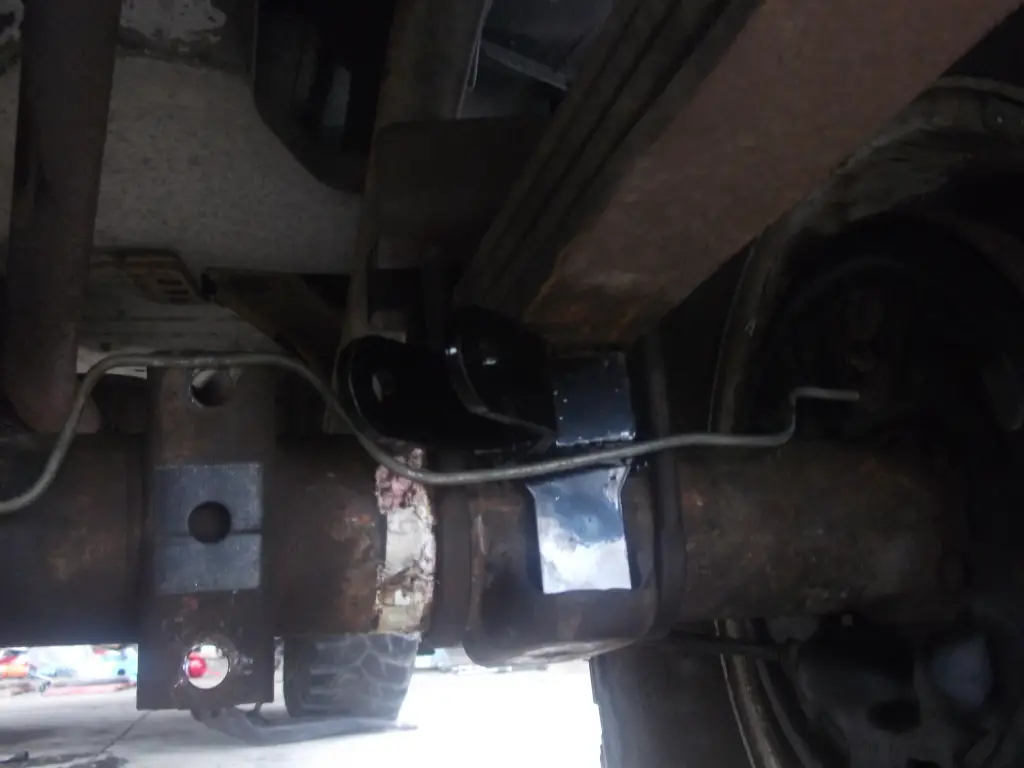

Rolled the Rear axle under and started hooking stuff up!!

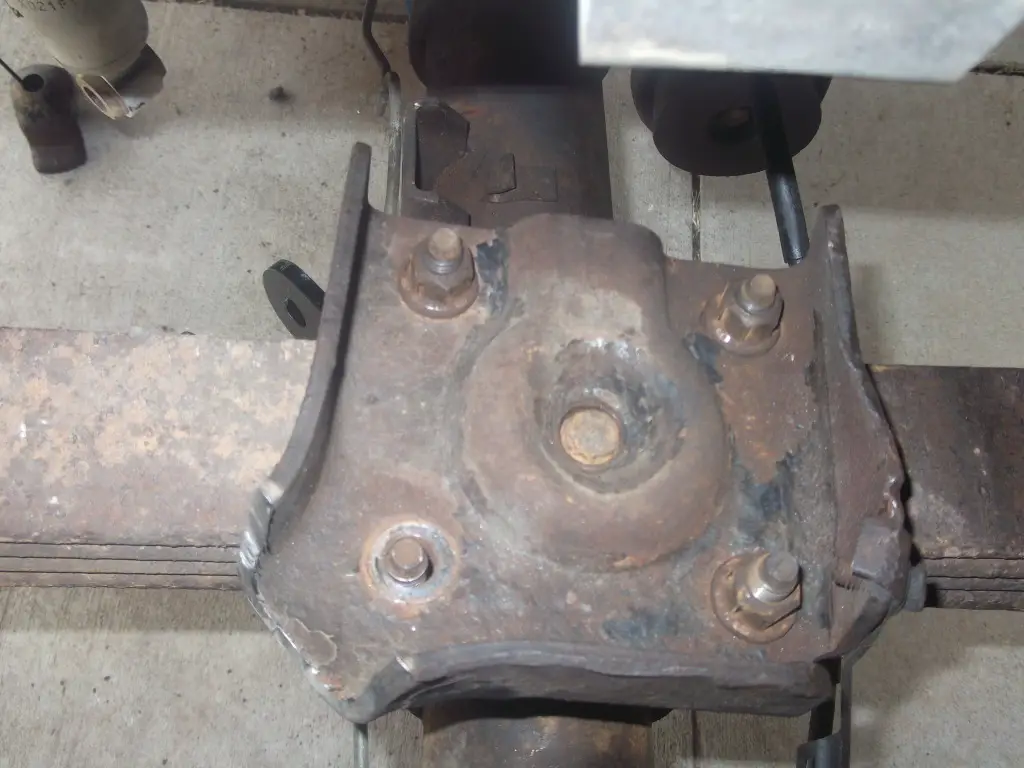

Had one Ubolt that the threads got dented and i didn't notice it until it got stripped so i will have to go to the pick and pull tomorrow and get another one.

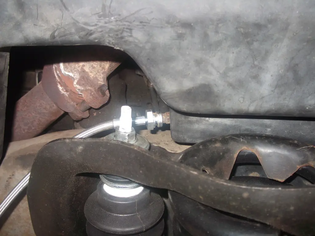

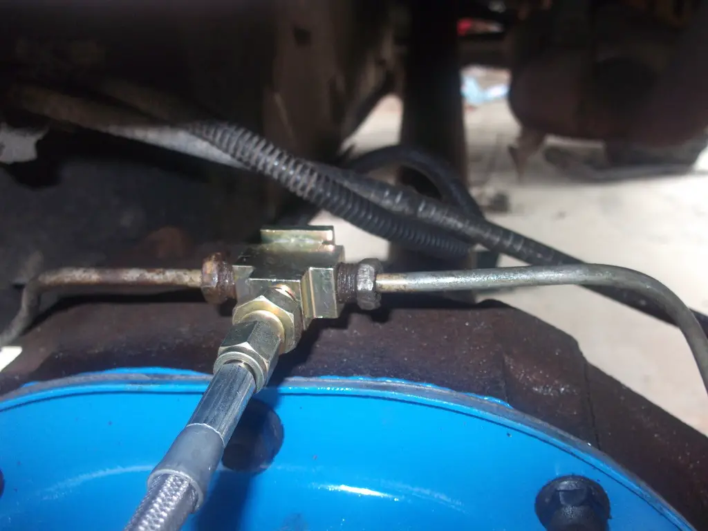

Had to reroute the brake line on the passenger side cause it was making me nervous.

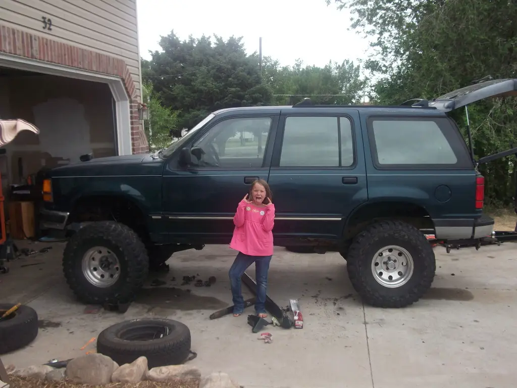

Then after getting the rear brakes all hooked up i bolted the new wheels and tires on and my daughter wanted to take a couple pictures with the truck so here they are.

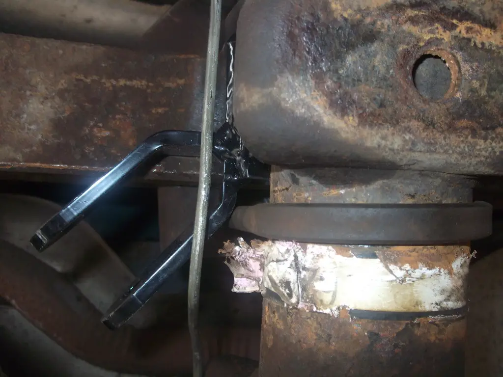

Ok so I am REALLY close but still have a few things to do. I want to go back over everything and make sure i didn't leave any bolts loose and make sure everything is torqued properly. Then i still have to install the new crossmember in place of the old radius arm crossmember. I have to Replace a Ubolt, Hook up the shocks and rear sway bar if i decide to keep it on there. I have to replace a ujoint in the front drive shaft, bleed the brakes, adjust the brakes. And hopefully figure out what to do with the emergency brake cable because the drivers side cable isn't long enough to reach so for now its not hooked up but it will be once i figure something out.. So anyone who has done a soa on the rear please tell me how you did it because i am at a loss.. after that i think i will be ready to move it in and out of the driveway several times to get the suspension to settle then i will adjust the alignment. Seems like alot when its typed out but really there isn't much left and it will be done tomorrow with the exception of the e-brake not sure if ill figure that out tomorrow or not!!
