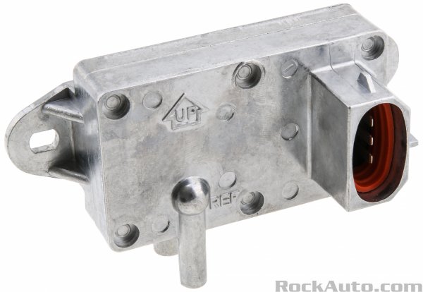

I finally figured it out!
When I was taking the Upper air plenum off to get to the distributer I had to take all the wire connections off, so I thought what the heck, I'll try and re hook up the battery and see if the Fuel pump shuts off after couple seconds. Sure enough it did! So one by one I started hooking up the connections and BAM! it was the friggen EGR pressure feedback sensor (Pictured) I by passed it, put everything back together and it started right up!! YEAH!

I want to thank everyone who tried to help me fix the issue, I knew it was something simple by the way it ran just before I shut it off.
