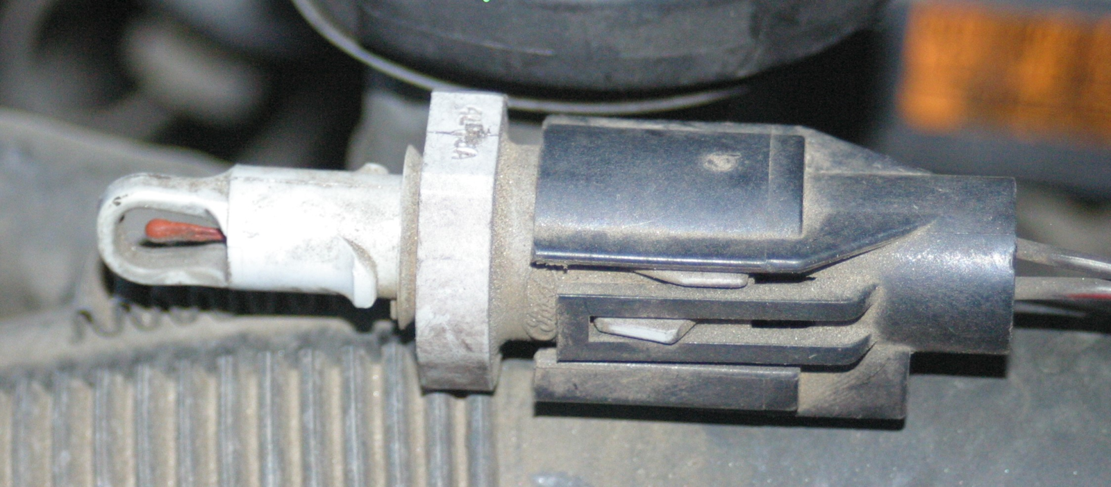

Looking at the engine, I noticed a dangling wire on the left side of the engine (looking from the left front and pulled it up to see what looks like a sensor of some type. the picture below shows the wire and sensor(?):
I do not see where this should be attached. Can anyone tell me what this is and where it should go? And if this popped out, would that cause the bad driveability?

It's a air intake temperature sensor it goes into the air intake, in between your air cleaner and your throttle body...you'll have unmetered air going in the motor, probably causing it to run bad...
you should see a hole there just pop it back in, see if that helps, don't know how it poped out maybe you have other problems also...

Oh, Thanks! I'll put it back in again in the morning and see if that helps. I have a service manual for a 1996, but it didn't help much; I'll go back and re-read it.

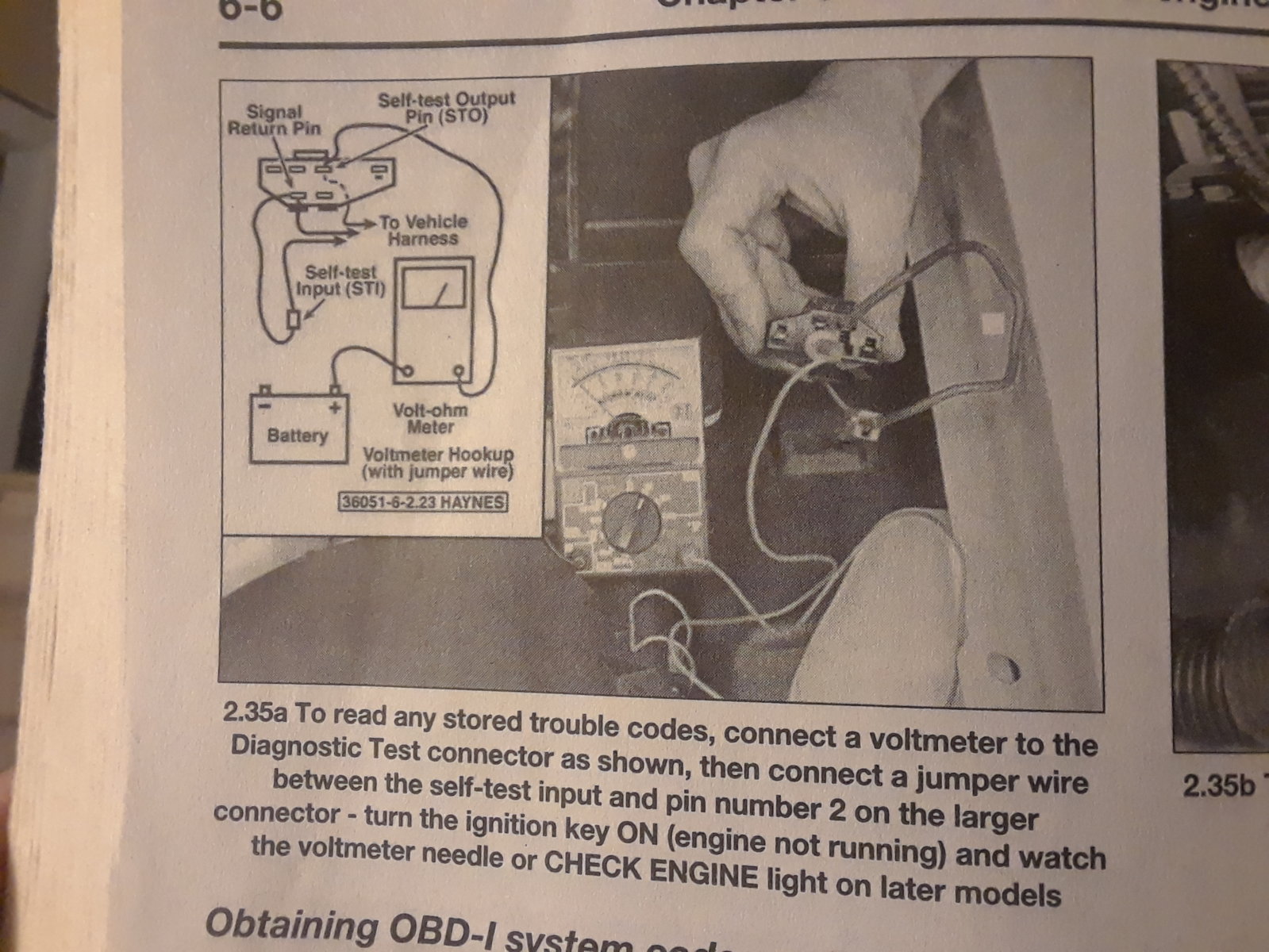

I also have a 95, it's an eddie bauer tho. Obd2 readers don't work, as they weren't incorporated in the explorer until 1996.
You have to check the codes manually, either with a voltage reader, or in some cases, the cel will flash giving the code readouts. The process is as follows..... Actually I'll just upload a pic of the manual page it comes from:
The wiring harnesses referred to are in the engine bay, right next to the fuse/power distribution box, drivers side next to firewall....in my 1995 eddie bauer 4dr 4x4 v6

You probably had a backfire during the start which blew the sensor out. Hopefully that's all the damage it did, minimally it could have popped other vac line(s) off, or blew the intake manifold gasket.
I am certain that having that sensor out can have caused poor running and a check engine light by itself, but as mentioned above it may or may not be the only issue. I would reinstall it, see how it runs.

A 96 would make a world of difference, because it has a misfire monitor to detect the problem cylinder, and is full OBD-2. It is unlikely Autozone still has the old scanners, but they may. I don't believe it can show misfires. The MT 2500 red brick (which is dirt cheap on ebay), may give live data streams for this system. There is also a 25$ digital reader which does tests. I hate the blinking light method. There is also a cylinder balance test on EEC IV that will tell you the bad cylinder. Was a while since I ran that! I'm sure a 95 will have full tests and data.

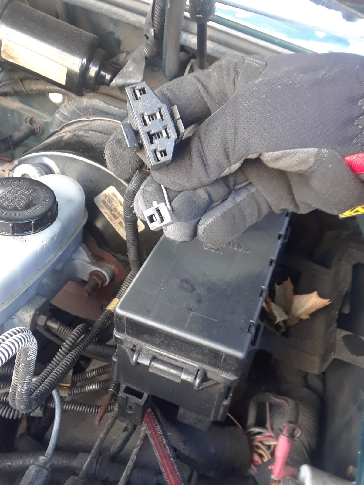

^ I'm going to look into those readers for sure. Yeah the blinking light method is archaic, but it works and is kind of satisfying in a weird way lol.
Here's a pic of the connectors.. Is that where these scan tools you're talking about connect 96eb?

Yes, that is the DCL and the single wire is the Self test wire I believe. That connector can read live data streams.
