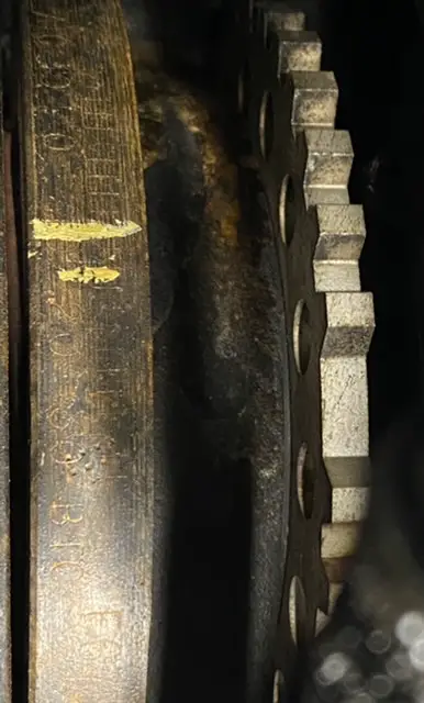

A stuck lifter would make noise that you can hear from ten feet away - not to mention that the affected cylinder would have low compression. Before tearing into anything I would check for separated tone ring on the harmonic balancer. I am looking at one as I am writing this and can see that the double-wide gap is centered at about 25deg BTC. If you see it more than a few degrees away from that spot, you found the problem.
Looks right to me?
