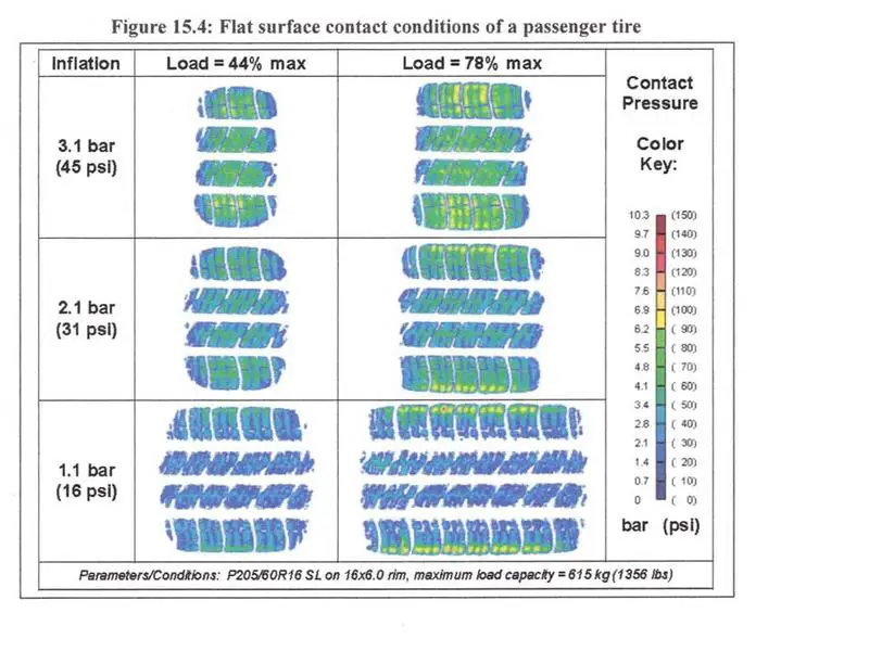

To each his own but I'll air down, even for on road snow driving. I can get down to the road surface just like everyone else, the same way (skinny pedal).
I'd much rather have the additional surface area at the contact patch.

I do air down for winter, but I think 20 PSI is excessive for light on road snow. 35 is a good spot.
Next time it snows, I'll air down my A/Ts to 20 and see what happens. I do remember airing down my old All seasons to about 22 since they were garbage on anything that wasn't dry..
