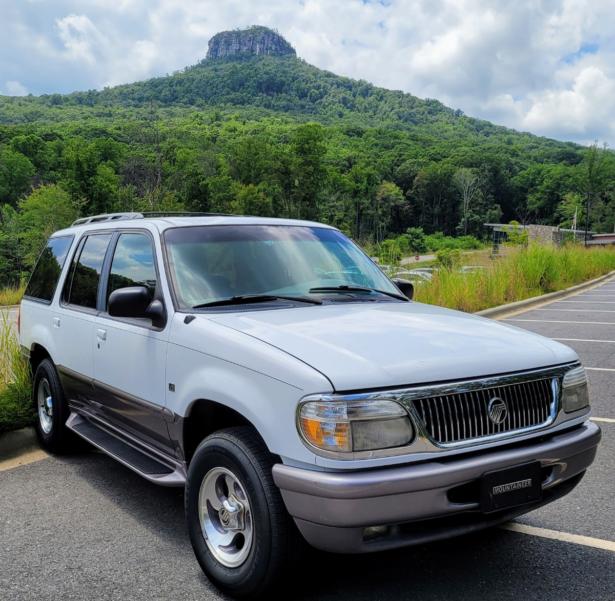

Thanks yeah it is my coming to America gift from God :) Our first car here, Im an Aussie that lived based in Korea traveling around Asia for 10yrs and moved here with my wife 6 months ago.
I wish I had a garage, it's been garaged its whole life and will be back in one soon.
It looks newer than all the 2010's and most 2020's cars in my complex.

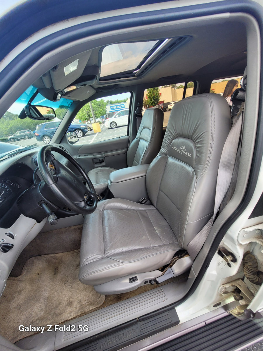

Since this pic I got genuine old stock MOUNTAINEER floor mats for $80 from Ebay and new cruise control buttons for the steering wheel. Dash and all controls are perfect. This pic was actually the day I bought it, so have gone around all little bits of the door frame with a brush since then also.
