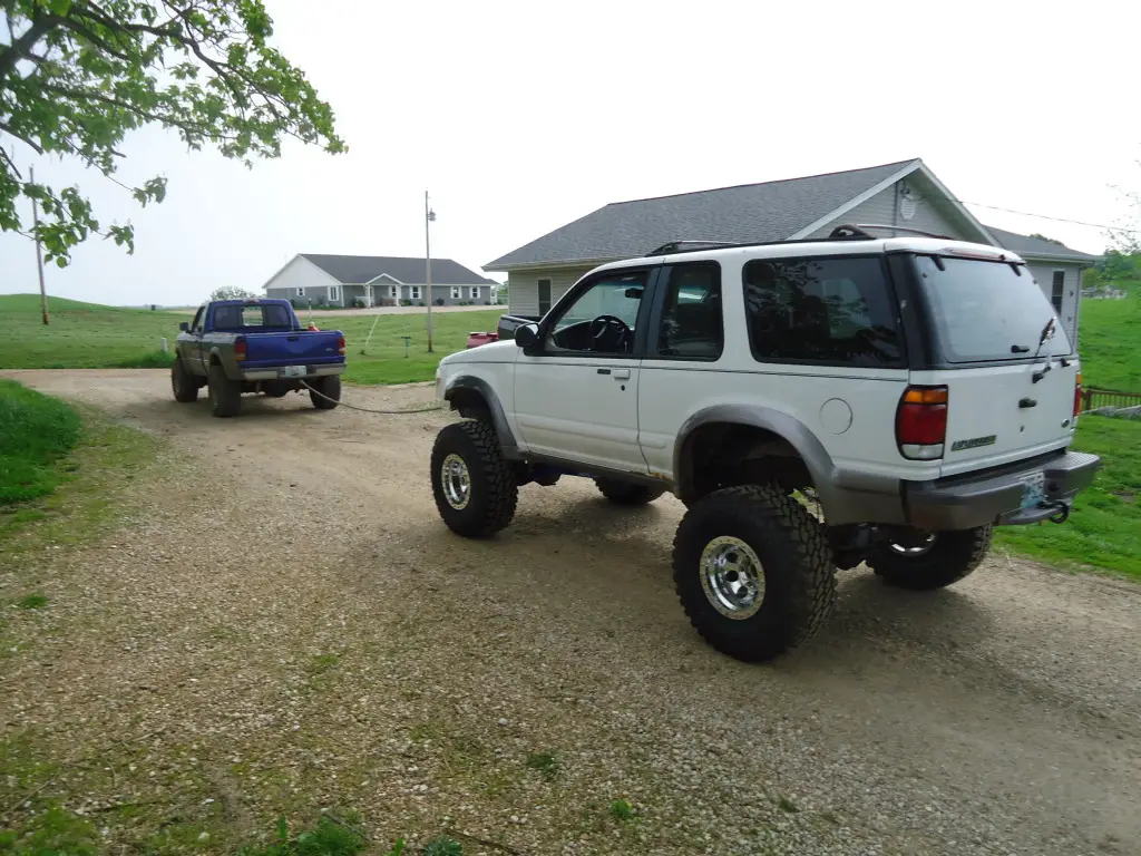

Update: Front brakes ran, everything hooked up, axle went thru, lockouts installed, stage 8 lock nut, clutch pedal installed and bled, throttle cable, condensor, radiator, rear axle pinion angle pads reset, rear driveshaft spare built, extra driveshaft getting balanced, body bolted down, steering shaft hooked up. Transfercase lever modified and installed. Rear stock bumper attached, start of custom front bumper hooked up.
Pends rear detroit and gears install, rear brakes, bleed all brakes, small wiring things, gas tank mounted. Alighnment DRIVE!!!!!!!!!!!!

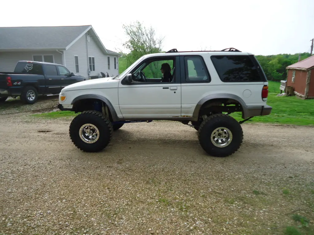

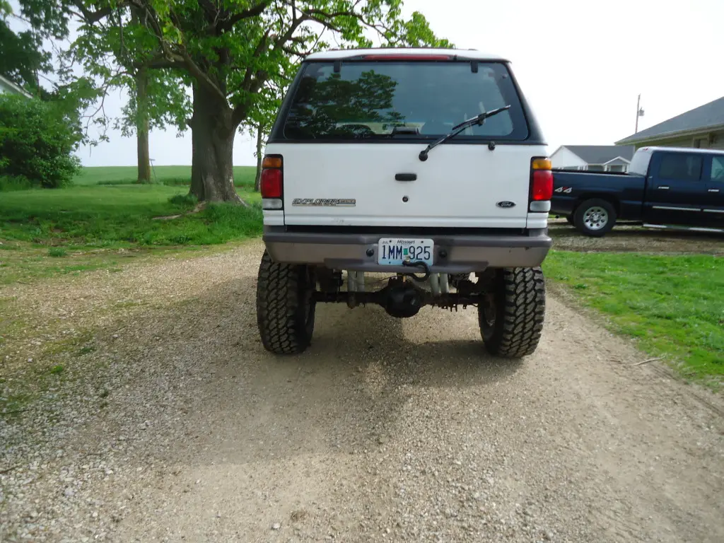

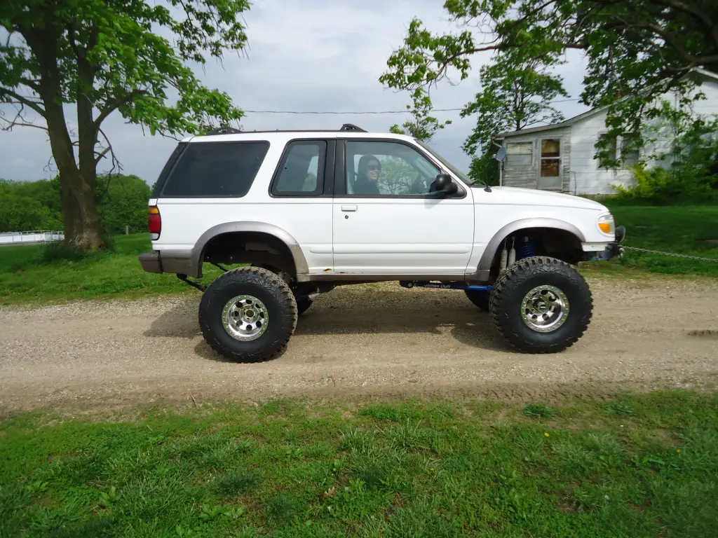

Once tank, subs, rear tire and springs settle hopefully will sit level
Todo install gas tank
shifter boots
add to front bumper
lower rear if doesnt level out
charge a/c

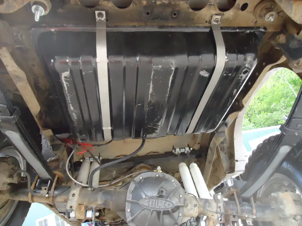

what gas tank did you end up going with? the one pictured earlier? I'm trying to find a tank to enable me to use an E4406.. I've been given one of a full size bronco, but I'm not sure I can make it work...

Gas tank is from 91-E150 Van thats major last thing left. I will get pics once Im working on it this coming weekend.

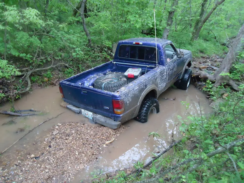

Had to break for a bit and do some wheeling on the farm, creeks were washed out from heavy rain and wasnt able to crawl the rock and tree root, then couldnt back up rear was on a gravel ledge.

Leveled
Gas tank swap, will post more details when I get a chance.
