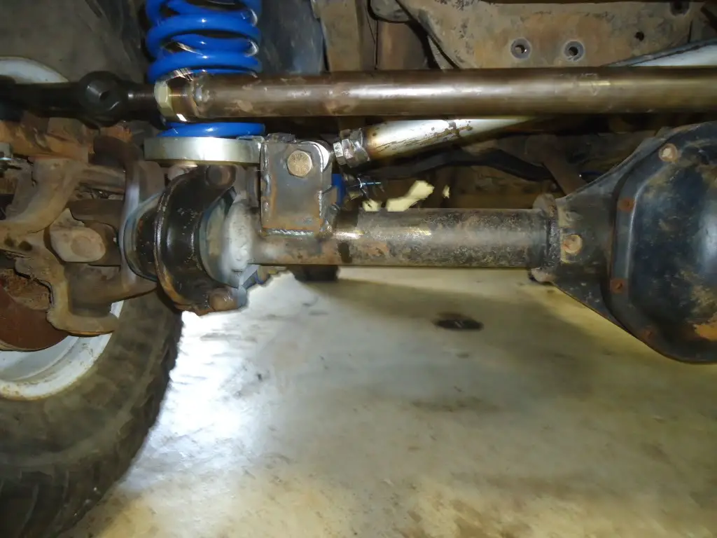

79 Ford Kingpin 60, welded on wedges, 5.38 gears, aftermarket shafts
60 rear, disk brake conversion, shafts, 5.38 gears
Custom Longarms
42-14-16 Swamper Iroks on 16x10 TR beadlocks
Unsure how much lift I'm gunna try to go with, I would like to keep it fairly low for stability, but dont want to trim fenders to to mcuh, but prolly will have to.
Will for sure have 3in body lift
6inches of suspenison, but might go for another 4 inches of suspension with rear lift springs. ..... not sure yet

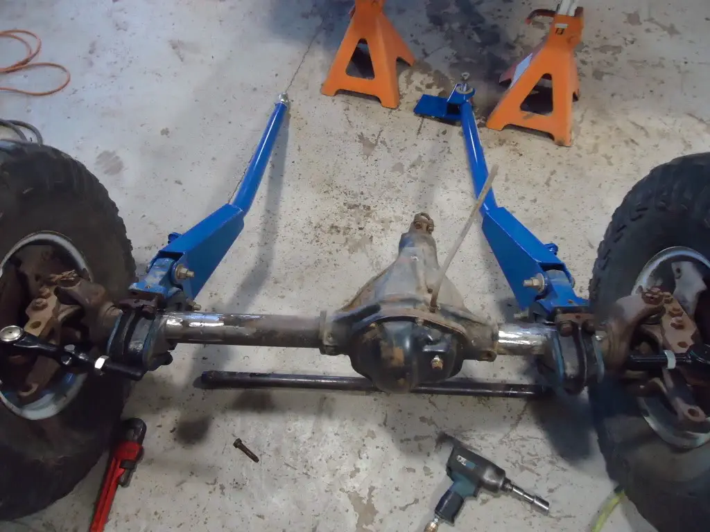

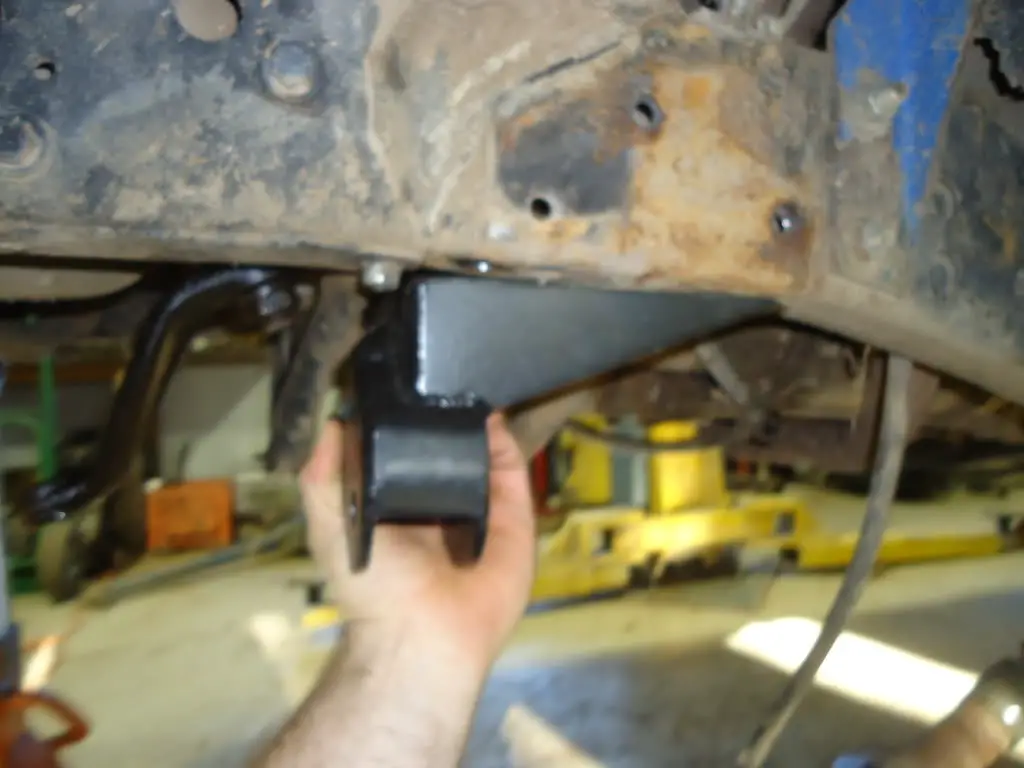

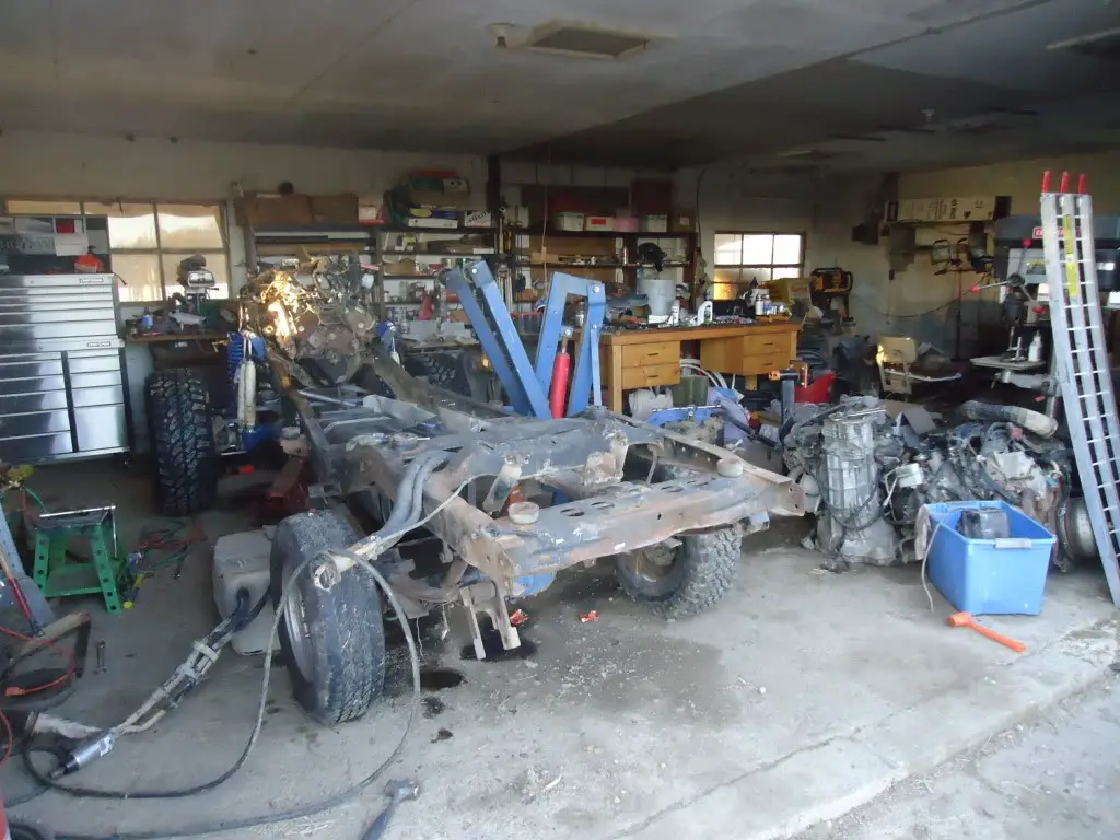

Starting on going back together

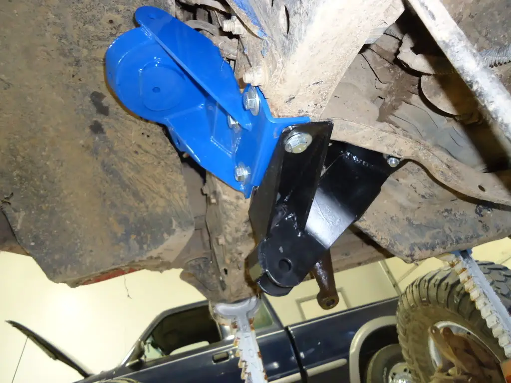

Old mounts all gone.

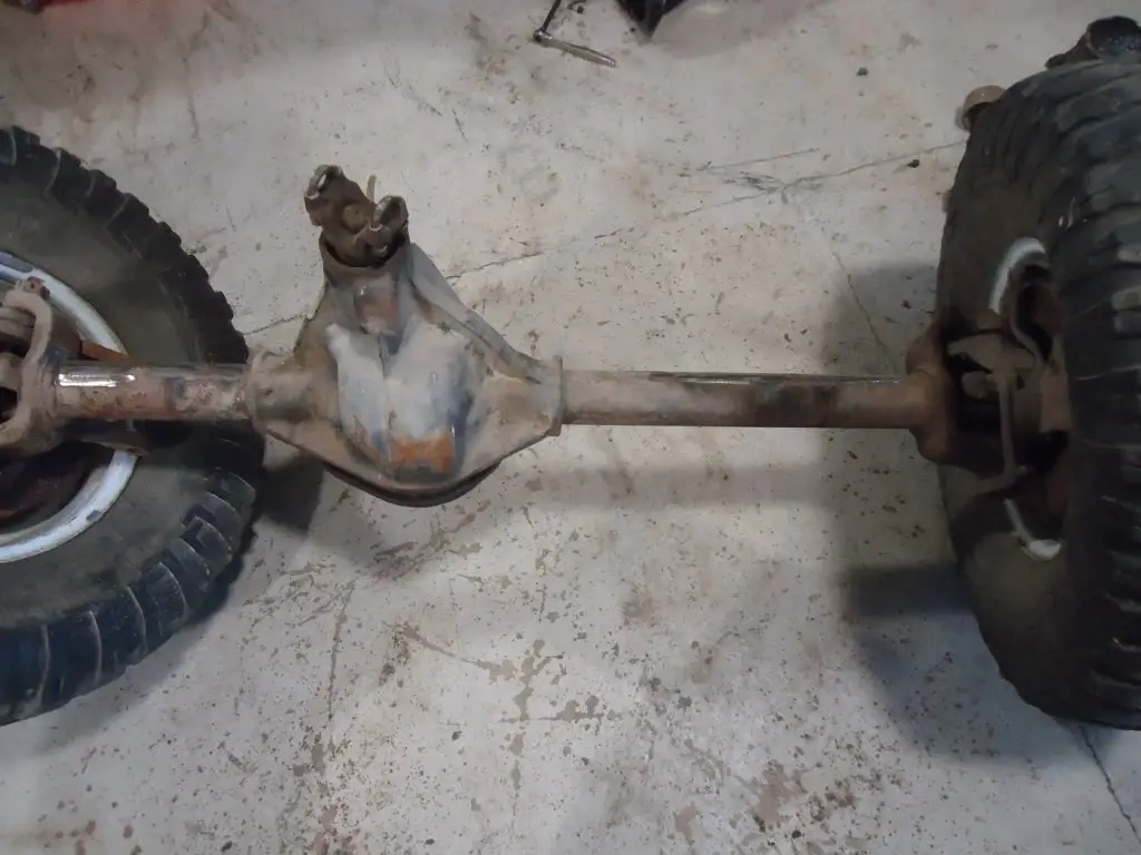

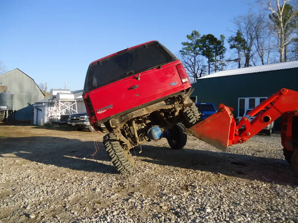

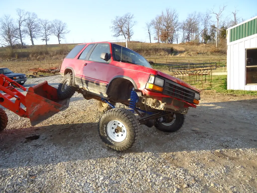

Sittn on its own weight!!!

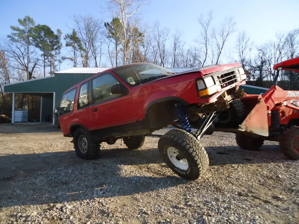

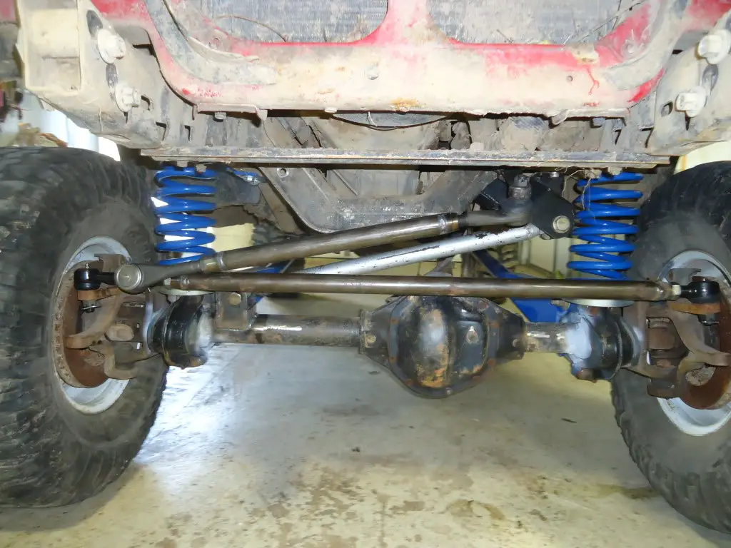

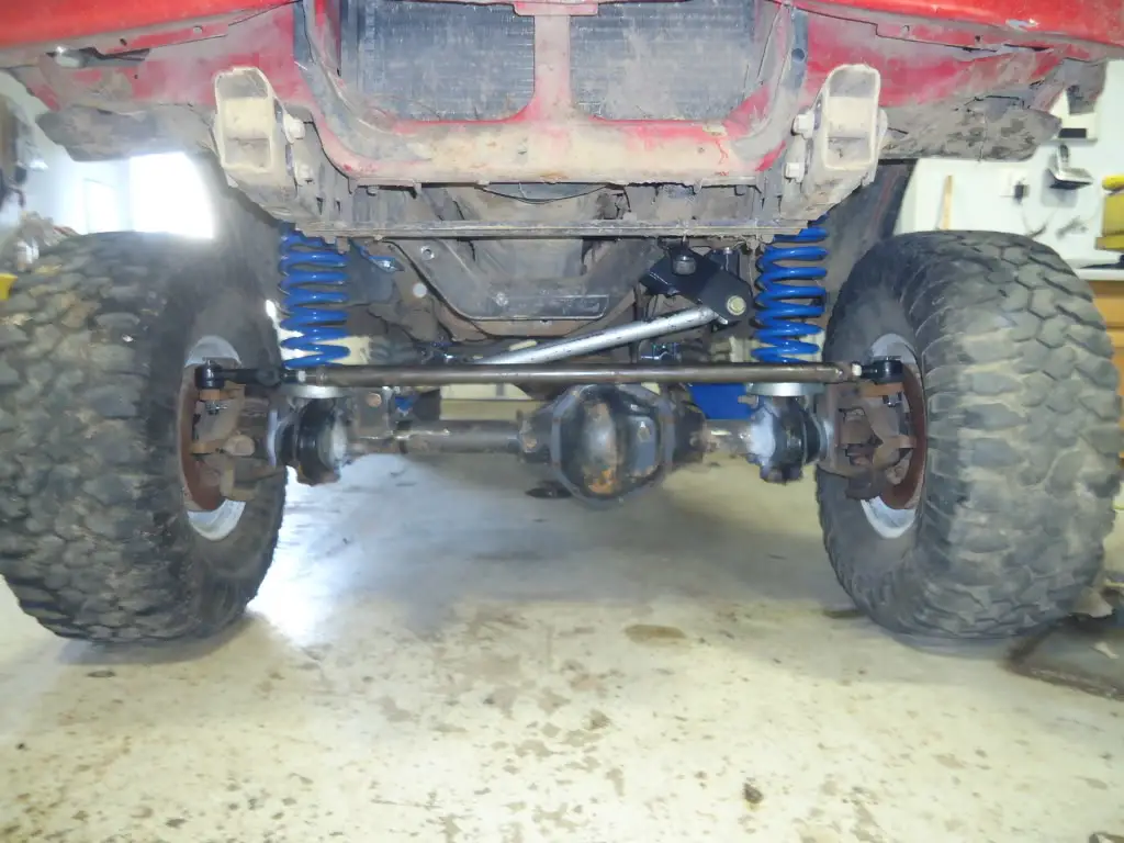

Checking to see if my shocks were long enough- which they are.

Now just waiting all week!!! To go back and work on her some more. Hopefully get the old body off and new drivetrain mounted...
Not sure how im gunna raise rear yet to match front... I dont like shackles hanging down or using blocks, but 4in springs might be to much, I will wait and see after v8 is in and calculate for a rear bumper with 35in spare and 2 subs. Id like it to sit level.

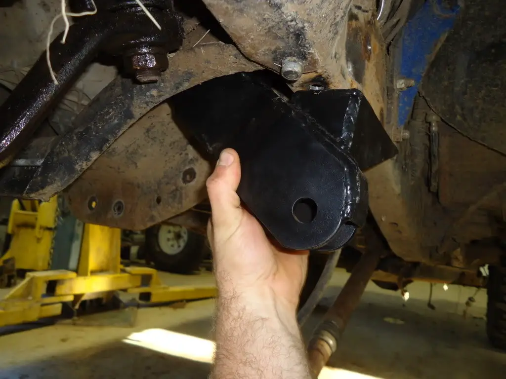

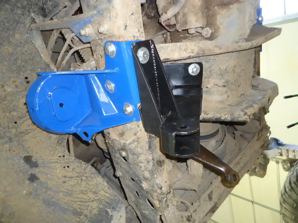

O and I had a drop pitman arm that ended up being to much, I had to go to a friends and get an almost flat pitman arm. I used my reamer to make it fit the 1 Ton GM TRE.

Update: Body is off the 97, been working on stripping off all the other good parts and things I'm keeping. Sorry no pics.

I went and looked at this build yesterday, and am amazed how easy Brad makes it seem to accomplish. I guess just like anything else, once you have done something a few times, it gets easier with knowledge and experience.
Looking great Brad! Can't wait to see it with the new body on and the 5.0 train installed. :thumbsup:

Progress going a little slow, and will be busy for another 2 weeks before I can mess with it again, Red body is off, new wheels and tires arrived. 15x10 Mickey Thompsons, with fake beadlock, and 35-12.50 ProComp Extreme Mud Terrains. They look good.

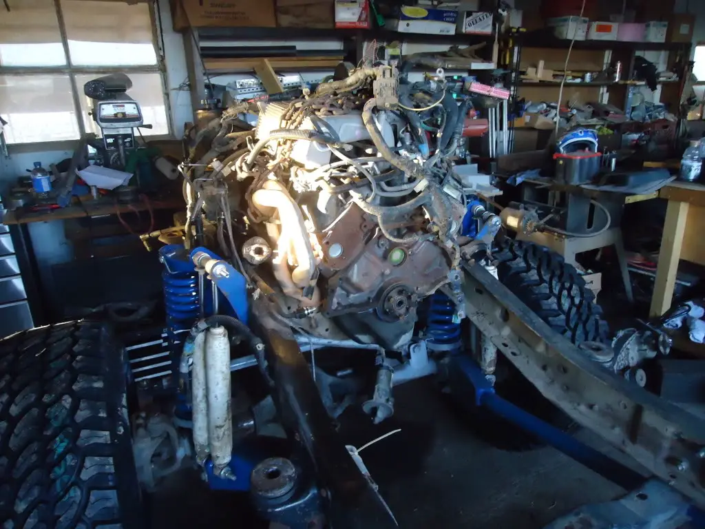

Slow? Not bad for 3 weeks since I seen it last!
Lets see, the 1st gen body removed, the 4.0 removed, the 5.0 installed. Pretty fast to me! :)
