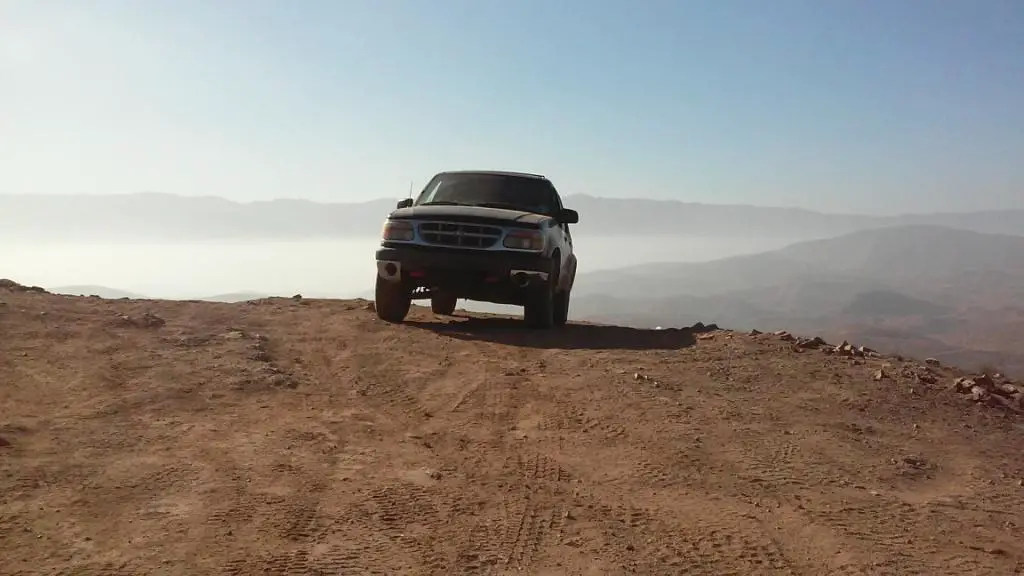

Where is this at? Looks like you had fun.Reaching top of highest peaks (for most part) pics from today's adventure.....where some fear to venture
View attachment 424273 View attachment 424274
WOW The Smog is unreal there now. I grew up in the High Desert back in the 80's to early 90's. Left So Cal in 93 and haven't been back./\ In Corona, CA.... the last "local" spot left in So Cal without a 2-3 hour drive to get to...
