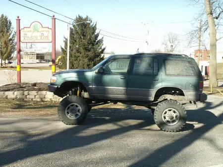

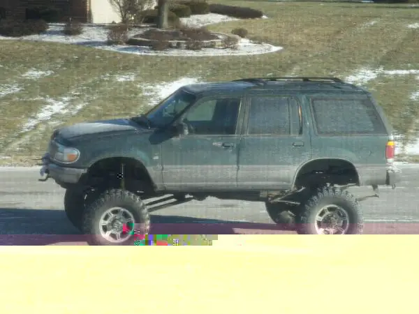

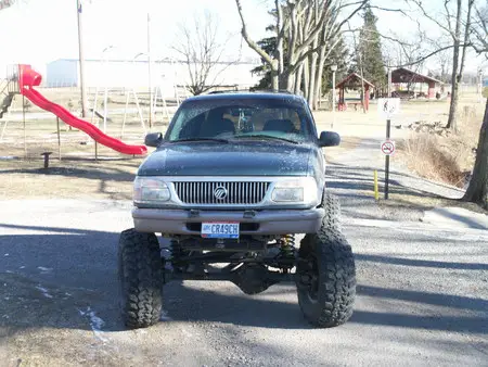

it got warmer, so i drove to the town i grew up in and took some pictures.
Which coils are you using. Are they XJ coils? How long are they? Spring rate?
rustys 180# 8.5-9" springs. too big and too stiff.

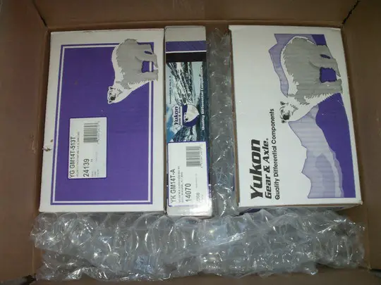

gears came today

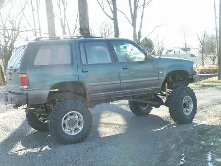

14 bolts in. Steering stabilizer mounted (truck no longer death trap) and 5.13's. im getting 17 MPG!!!!!!!!!!!!! I am darn happy with the new gears. At this rate the gears will pay for themselves in a month.
Also i had a new driveshaft made out of .095 wall as compared to the stock .083 wall. It has Zero runout too.
