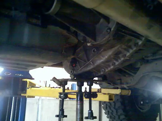

Welp shes in. I have the pics on my camera phone, if anyone knows how i can get the pics on the computer be my guest and tell me how.
The whole swap took about 3 hours and add in a half hour cuz i had to run to the store to buy the u-joint.The stock gas tank will fit.......barely. You need to trim down the bracket side for it to clear the case. The driveshaft clears the tank with about an inch to spare. I had to loose the plastic top that sits on the gas tank too. To my dismay on the road test, ford has adifferent speed sensor for the f-150's...der. So i have no speedo or odo. I have to change it out with the vss from the awd case. Also, the AWD case is a bitch to get out. Make sure you have a pry bar, becuase mine was very stuck.. I had to get the hybrid u-joints from autozone..11.99.

Now post them in here. Click on them and copy the

I need one of those lifts! :D What were you torching??

(section525 :I need one of those lifts! What were you torching?? )
The gas tanks and skid plate mount...it hits the fins of the rear shaft, so we had to cut it. Just some, but its still just as strong.
