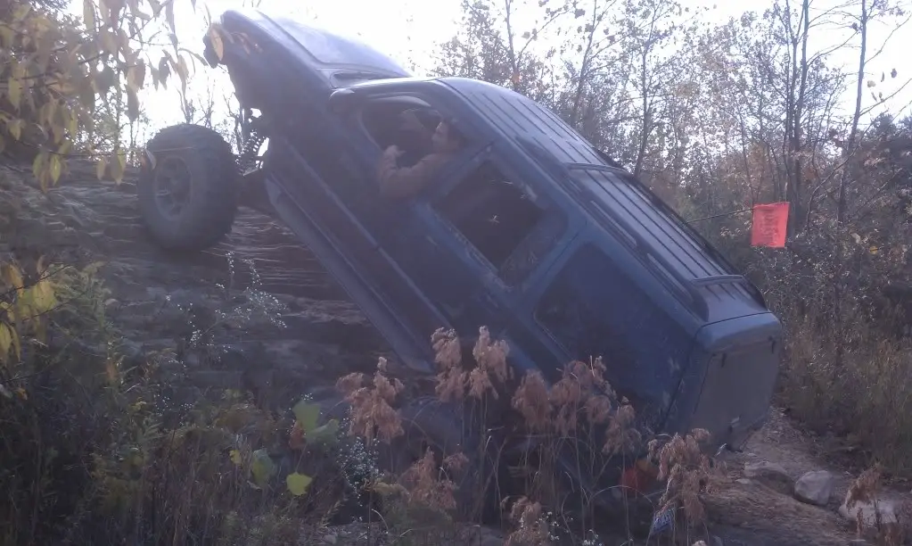

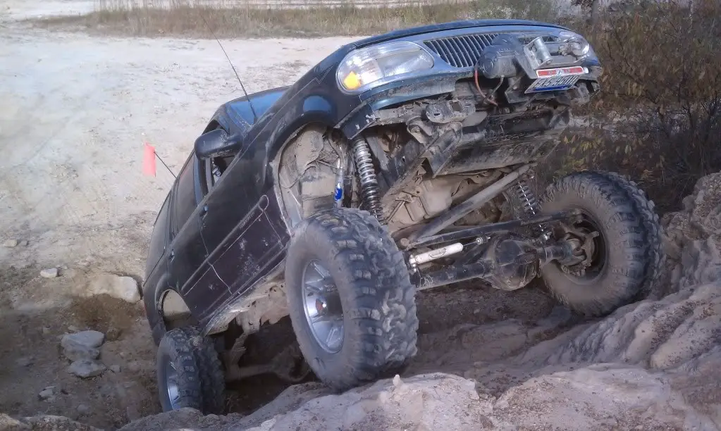

Last Summer, around august i swapped the crushed body, and then my friend and i did a coil over conversion and brought the height down some.
Front suspension almost completely unloaded. Had an issue with the transmission pump not picking up the fluid in the pan since i was so vertical..all forward movement stopped.

Have you come up wtih a fix for the transmission on steep inclines? Mine does the same thing, comes out of gear on steep climbs.
