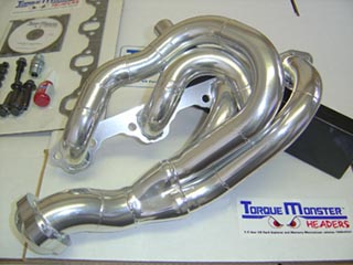

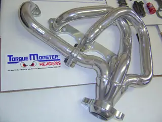

Torque Monster Headers will be a big help in many areas. They work well with all OEM emissions equipment as well as modified Add-Ons. Give it some thought... $589 plus $35 shipping gets them to your door.
Check them out at: http://www.torquemonsterheaders.com
Also: http://www.explorerforum.com/forums/showthread.php?t=147452
