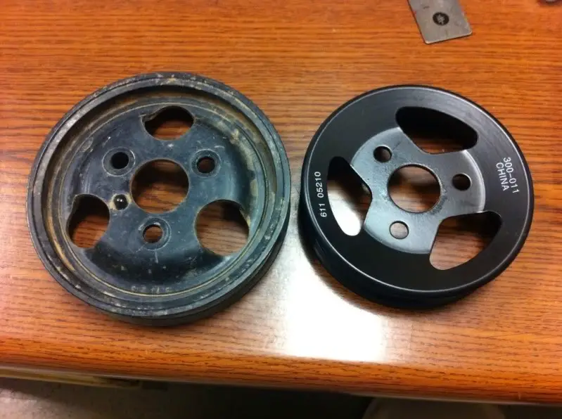

here they are side by side
EDIT: issue #2, the holes dont line up, looks like a no go.

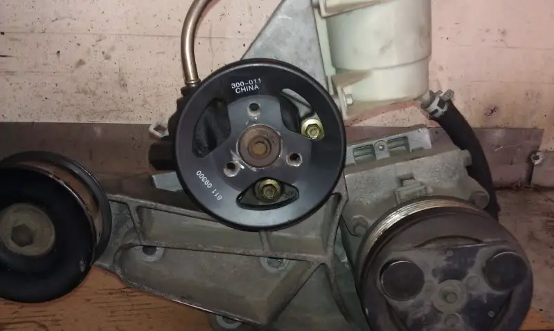

Here we go.
Both pulleys this is spare setup I had from used Explorer motor I picked up awhile ago.

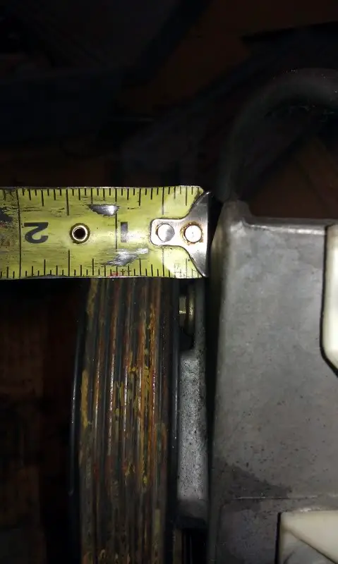

Stock pulley clearance...

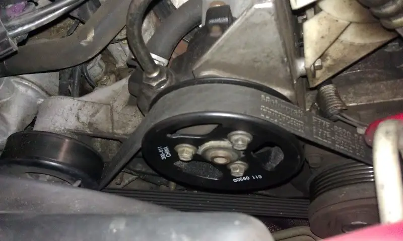

Escort pulley clearance...
I oblonged the 3 holes with a dremel to fit doesn't take much. And the center hole I drilled out with 1 1/8" uni bit and clearanced it a little more with die grinder.
Installed and works like a champ.
Whole job took me about 30-45 mins.
