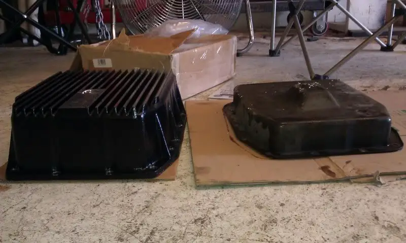

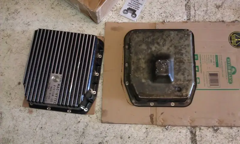

Think I figured out my trans issue. Guy who used to help did the filter change for me. Well he left the old filter gasket in the pickup and stuck the new filter and gasket in behind. Leaving me with a bad seal. When I would drive normal it was a non issue cause the fluid was up to the valve body and it would suck past the gasket. When I would get off camber the seal would leak and not let the trans suck up fluid. When I pulled the pan the filter starting falling out I was like what the heck. Pulled the filter down and thought no wonder. Sigh like my buddy used to say you can't get good help you just get help. Lol

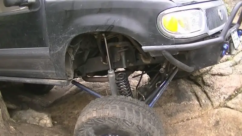

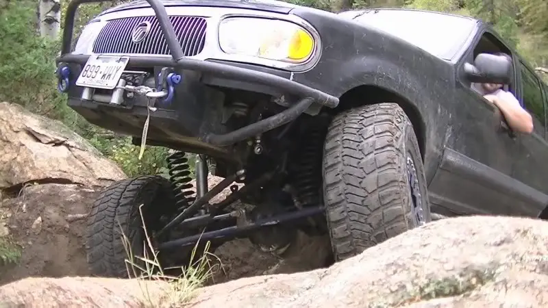

Yeah I went with one other guy. He was nervous about heartattack hill so we did the bypass which I don't think was much better. LOL It was fun. I tried the chutes and ended up denting drivers rear door. It was raining and I slide off the rock and banged the door. I did try the big boulder on the right but my coil kept popping out so I gave up cause my spotter told me I couldn't make it. But after I got out and looked I think I could have made it. But it started pouring and was making it a lot harder so we cut our loses and hightailed it out of there. LONG DAY!!!! LOL glad I got to do it before the season was up.
