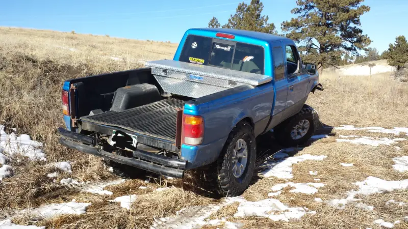

Do you have any pictures of the back bumper from the backside, specifically the tow hitch and how you have it all reinforced ? I'm building mine and will be integrating a tow hitch into it.
Thanks, I'll check them out.

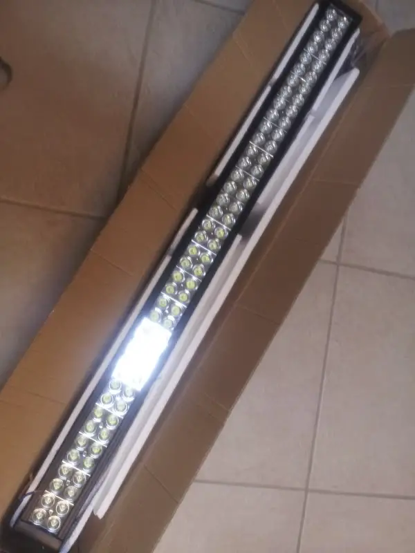

I ordered some LED bars for Double R got a 40" bar for the roof. They are doing a giveaway on 40" bar if you like there Facebook page. Spread the word maybe someone on here can win. They also have pretty good prices on all there LED bars.
https://www.facebook.com/OlympusOffRoad

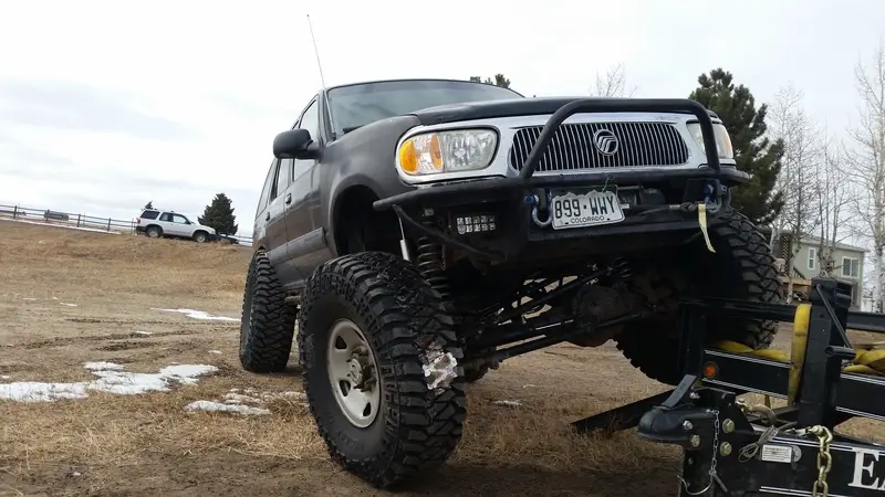

Merc turns 2 (since it's first test drive) tomorrow so proud of my first SAS(personal swap). These trucks are great stock which makes a great platform for a wheeling rig. 28k mile since the swap. I drive it almost 3-4 times a week all over town. The Dana 30 has held up amazing I figured I would have had to swap a 44 in by now but I am still rocking stock shafts with just D44 U joints and welded on caps. Most issues I have had is a broken shock mount since I went Monotube shocks. Truck just keeps firing up and getting me where I need to go with little fuse. I am glad I decided to build this rig over my Jeep. Can't wait to see what I do to it in another 2 years. LOL
If you had built the Jeep, we probably wouldn't have met. I'm glad you built the "Merc" also. :thumbsup:
Yeah the Merc has opened the door to meet you and a lot of other great people. I need to get it ready next week for a big 2000 mile road trip. Need to go over it with fine tooth comb make sure it is ready for that much seat time. :D

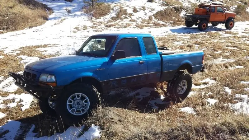

Another SAS on Torsion bar RBV. This Ranger already had a 5.0 swapped in when it came to me...
I made some improvements over the Merc. Merc is almost 3 years old I have some new plans for it this year one tons and 40 plus tires... :)
