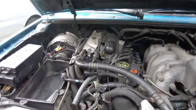

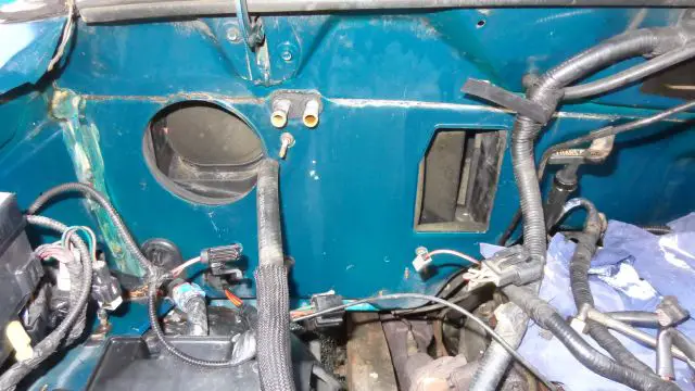

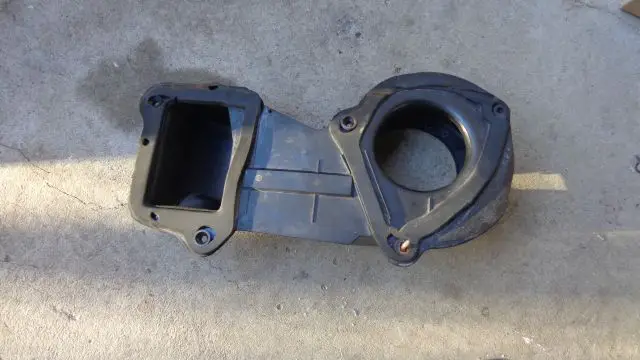

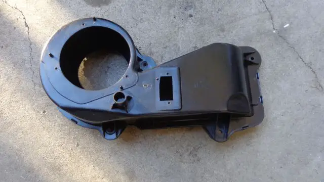

Changed out my AC box
Ok I removed my AC while doing my LIM gasket. here are some pics.
I found a Ranger box in the scrap yard cleaned it up and put it in. Sure is a lot more room in there !
Don't forget there is one nut under the glove box inside the cab, the rest on in the engine bay. I removed the blower motor 1st, makes the job much easier.

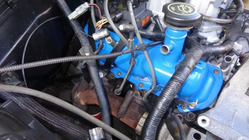

Vaccum Line
I rigged the vaccum line that used to run from the AC, to run from the fuel rail T connection over to the air box. All done, heater works great, thanks for this thread !

shamal, I couldn't help noticing that the v-shaped washers are missing from your valve covers. They help distribute the load/pressure of the bolt going into the heads. Without them, you might be looking at leaks unless you really gooped on some RTV in place of a gasket.
Thanks for the post natenkiki, there were none when I removed the covers. I only used new gaskets, no rtv except for the corners that meet the water jacket, and will keep a eye on things. If they leak, will let you know.
That means someone else was in there and didn't re-use those important parts. I did a quick search and I can't find any good pictures aside from this:
They're little spacers that spread out the force. The covers are thin steel and easily warped. You can buy aftermarket ones like this:
