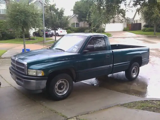

A friend of mine gave me this 1998 Dodge Ram 1500. The transmission wouldn't get out of 2nd and it needed some basic maintenance. He wanted to give it to a junkyard,:eek: but he called me up at work and asked if I wanted it. I said "Hell, yeah!" and brought it home a week later.
Specs:
5.2L V8 (230HP @ 4400RPM / 300 ft.lb. torque @ 3200RPM):D
46RE 4-speed Auto
2WD
Single Cab Long Bed
3.55 Gear Ratio
9.25 Chrysler Rear Axle
ST w/ Cruise, A/C, and fogs
126K miles
Towing Capacity of 8000 lbs
Exhaust cut off after Cats
Class IV Hitch 10,000lb GTW
When I brought it home:

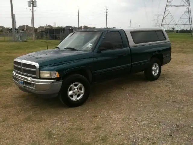

Now:

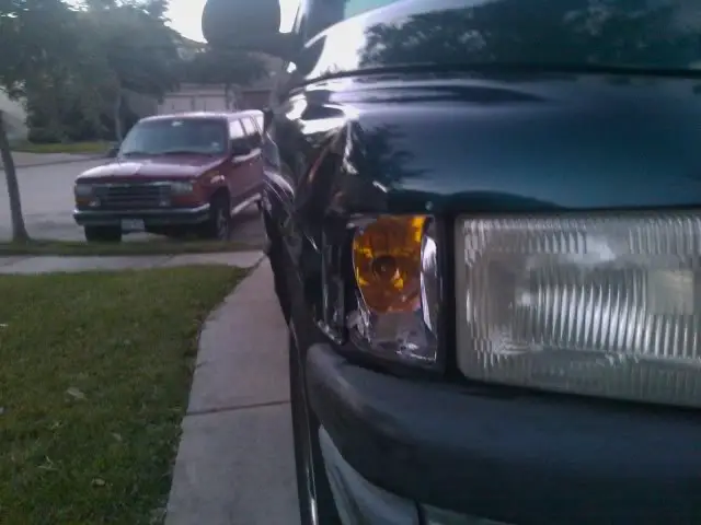

4. That same week, I hit a guy who didn't pay attention to traffic, crunching in the fender and destroying the signal lens.

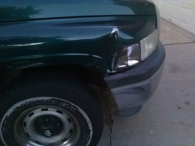

Truck was in a fender bender on the 14th. Nothing major, guy just didn't allow me enough room to stop when he pulled out of a parking lot. Police officer said, in his opinion, it wasn't my fault, so as soon as the other driver gets it through his head that his dispute will go nowhere I will get a check cut and fix Thunder.

I also finally got it registered with new plates. It was a heavy price and my wallet is much lighter going into the new year. :( I still have to fix the damage. The insurance company got back with me and found that their driver was at fault, so I am going to be getting a $1200 plus check for the damages. :cool: With what it'll take to fix the truck myself, we are talking about nearly $500 left over...maybe that can be used for Red? Only time will tell...;)

Got the check from the insurance company today. $1241. Not bad I think.

Put some new to me treads on the Dodge. The originals were bald and 30.5". The new ones are 31.6" and came with some new wheels. I really like the new look.
Old
New
I now have to hop into the cab and I am 6'1".
The exhaust tape fell off after a couple of miles and I just left it alone. It finally irked me enough that I went and got some exhaust tubing to put it back together.
However after getting under the truck to start making it happen, I realized that I wasn't going to be able to get the coupler on as the rear exhaust wouldn't move back far enough. So, I pulled off all the exhaust hangers. I then took a step back and looked at the piece of crap sitting on the driveway, kicked it and threw it away. As of right now there is no rear exhaust or muffler on my Ram. I did cut off a bushing though to replace a missing one for the front exhaust hanger.
I think this will work for now till I get a turn down. :D
