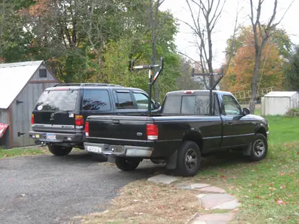

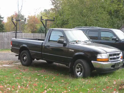

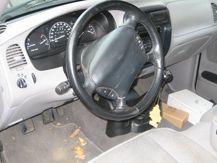

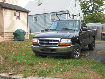

Just what the doctor ordered: 2000 Ranger std cab, long bed (7'), 2.5l 4cyl, 5spd manual, pw/pl/keyless entry/cruise/pwr mirrors/72k miles, 1 owner, recent clutch, she runs great!! The bed is a little dinged, and the rear bumper is AFU, but otherwise fine shape.

Let me be the first to say....NICE RACK! :D
Damn :p: I so wanted to say that. It was the 1st thing that came to mind when viewing the pictures of it.. The 2nd was about how much better gas mileage it has over the mounty. I'm surprised you hadn't bought a truck before now anyway considering all the construction materials you have been cramming in the mounty since you got her..
Anyway congrats on the new ride.. you'll need to make a new thread now :D
