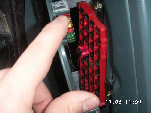

So i located the abs fuse and removed it. Its fuse #14 and is rated at 10 amps. I took two 3 foot long wires and stripped the ends. Then i soldered thier ends.
After thats i stuck fuse ends on the one side of the wires to plug into the fuse box. As shown in the picture.

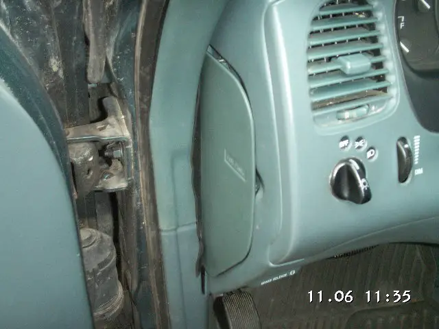

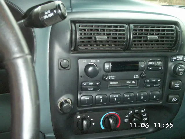

Then the other side i used connectors and connected to an on-off switch rated for 10 amps.
Now i have an instant abs defeat switch. The look is factory too imo. This took me about 30 mins ( i didnt have a 3/4" drill bit so i had to widen my 5/16" hole)
