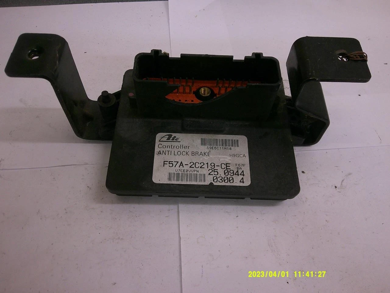

I want to test the sensor signals at the ABS controller end. I found a pin-out diagram, but I cannot find the module itself. One diagram points to the driver side front corner, but doesn't say if that's inside the engine bay or inside the fender.
A pic would be great but any help is welcome. Thanks!
For reference, I'm talking about this part, not the pump.
Don't know for a '95 but often the controller is next to the pump. Follow the wires from the pump to it?

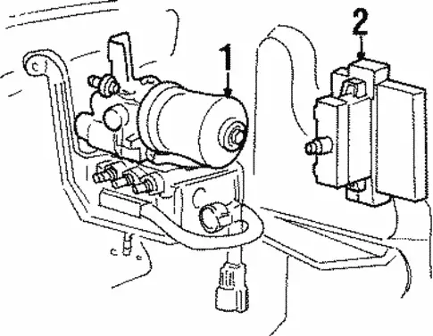

this is a photo for a 1995 ranger. it may be similar
No. I found it. The ABS pump (1) looks just like the diagram and is easy to find. The ABS controller (2) is on the inside driver's side fender, behind the battery and below the "engine compartment relay module #3".
Hopefully this will help someone in the future!
